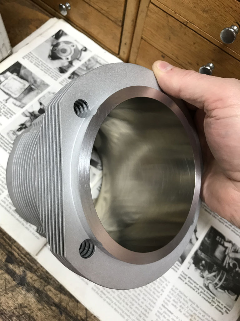

You want to look at the jugs. If they are "Nickies" you hit the home run.
They will look 911 "like". not VW finned. Aluminum with denser machined fins.

Raby serializes his engines so unless case has RAT serial number it’s probably not a whole Raby built engine . . . But you never know. If I recall Raby / HAM developed heads were sold on Type 4 Store years ago. Not exactly sure how those were stamped.
For OP - Nickies cyclinders are billet aluminum - very distinctive. Here’s a set of 100mm cylinders I have slated for a build as example of what they look like Attached Image
