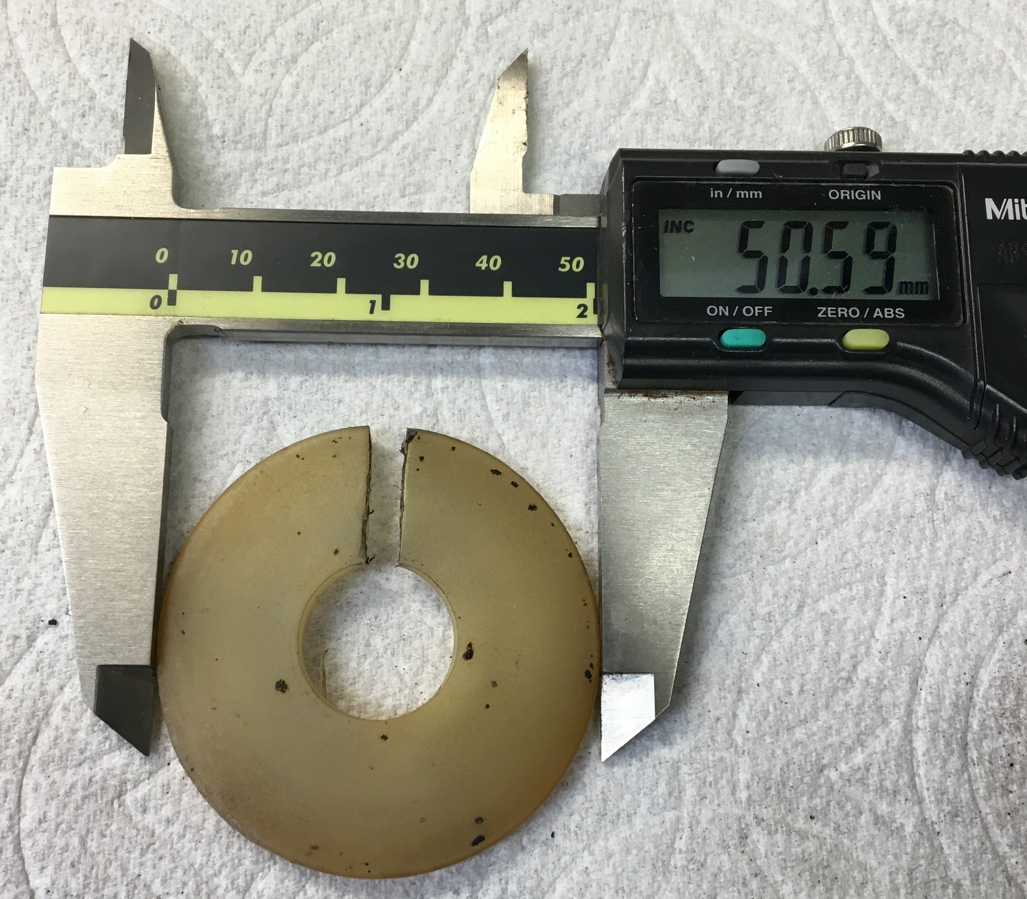

This is the only part that is non-metal in my Koni red leftover part setup. Seems like a compliant plastic.
Not sure it is #5 but here you go.

Montreal914   This is the only part that is non-metal in my Koni...   Jul 10 2024, 04:24 PM
