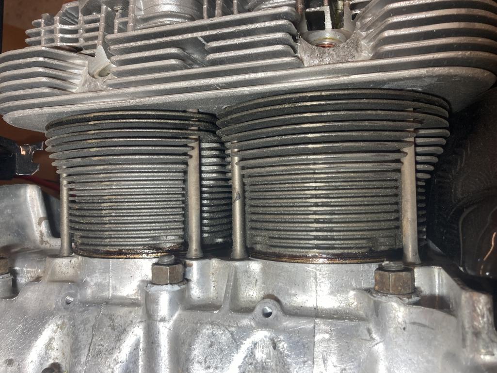

Pict of cylinder. Any idea what it is? I'm hoping to take one head off in a day or two and measure cylinder. Attached Image

Robroe   If I’m going to tear this engine down to inspect...   Jul 9 2024, 11:35 AM
930cabman   If I’m going to tear this engine down to inspec...   Jul 9 2024, 01:09 PM
technicalninja   THAT LOOKS PROMISING! You might have hit a ho...   Jul 9 2024, 04:29 PM
