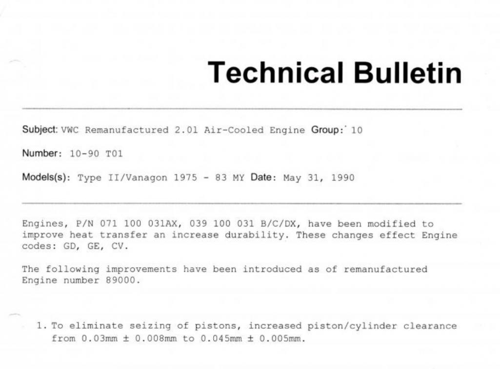

95.95mm in a 96mm bore equals .05mm PTW clearance or .002". This is a clearance for cast pistons... It's a TIGHT clearance for cast pistons in an air-cooled application! Not really. 0.03 mm was initial clearance when 914 engines were built. Per the Tech bulletin for the Bus engines the clearance was later opened to 0.05mm Here are OEM 914 shallow dish pistons for a 2.0L 94mm - marked 93.97 Here’s is the excerpt from the bus bulletin that has later been applied genetically by the aftermarket to Type 4 pistons and cylinders Bus would have had more susceptibility to seizing due to the brick in the wind aerodynamic loads plus the cargo loads that are way, way higher than the load imposed on a 914. So 0.05mm of clearance is more than adequate for a 914. I believe Raby has run Nickies with as low as .00075” (0.019mm) piston to cylinder clearance somewhere along the line. I can’t find the source for that so take it as unverified. That of course would be possible because the piston is running in an aluminum cylinder that is expanding as fast as the piston as it heats up. Side topic @technicalninja Comparison of HAM head to OEM (2.0L) ![]() |

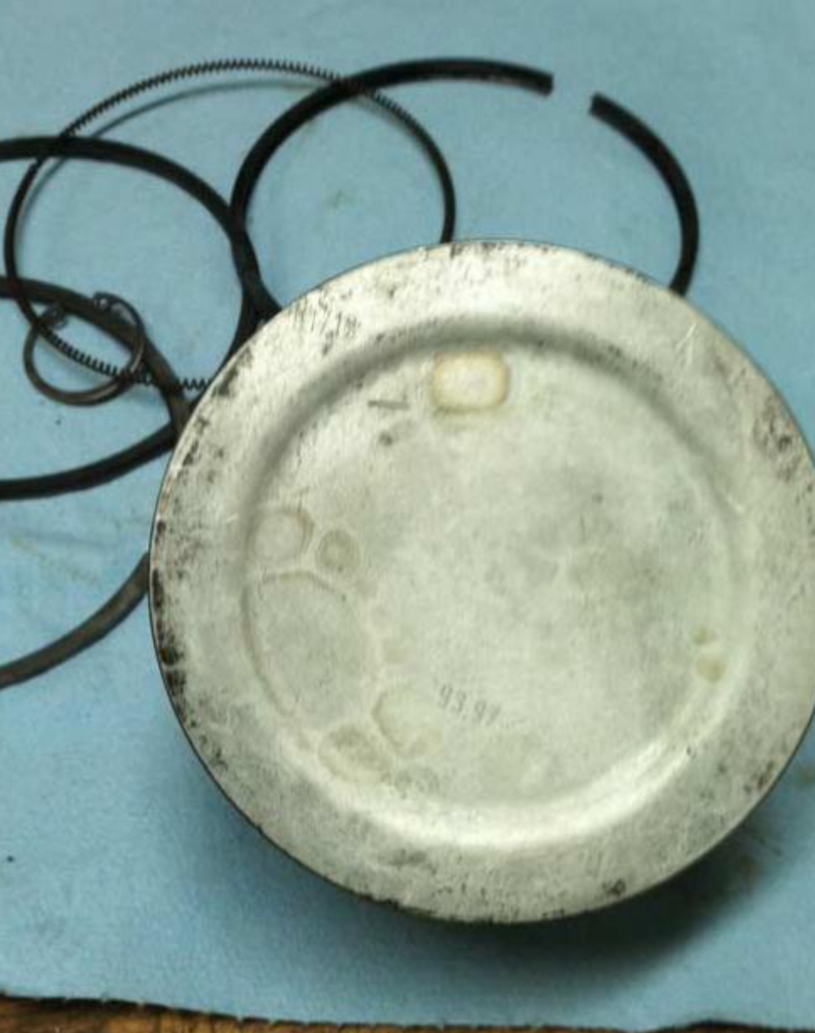

Robroe Boroscope just showed up. Pistons are marked 95.95... Jul 8 2024, 04:16 PM
emerygt350 They look like my 96mm pistons. If that thing is ... Jul 8 2024, 04:19 PM

technicalninja I DON"T like the raised 95.95.
I want the to... Jul 9 2024, 07:09 AM

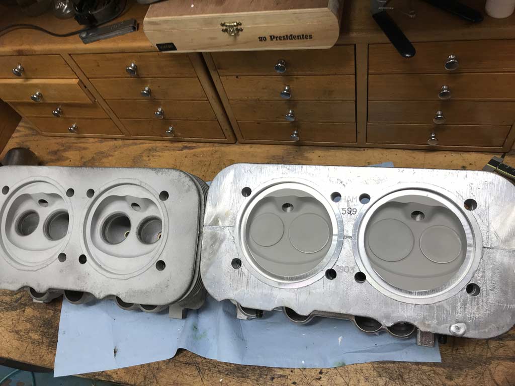

emerygt350 First of all, looks like 2.0 heads to me. Cylinde... Jul 10 2024, 06:56 PM

technicalninja Positives:
Heads- look like Raby heads with weldin... Jul 10 2024, 07:26 PM
