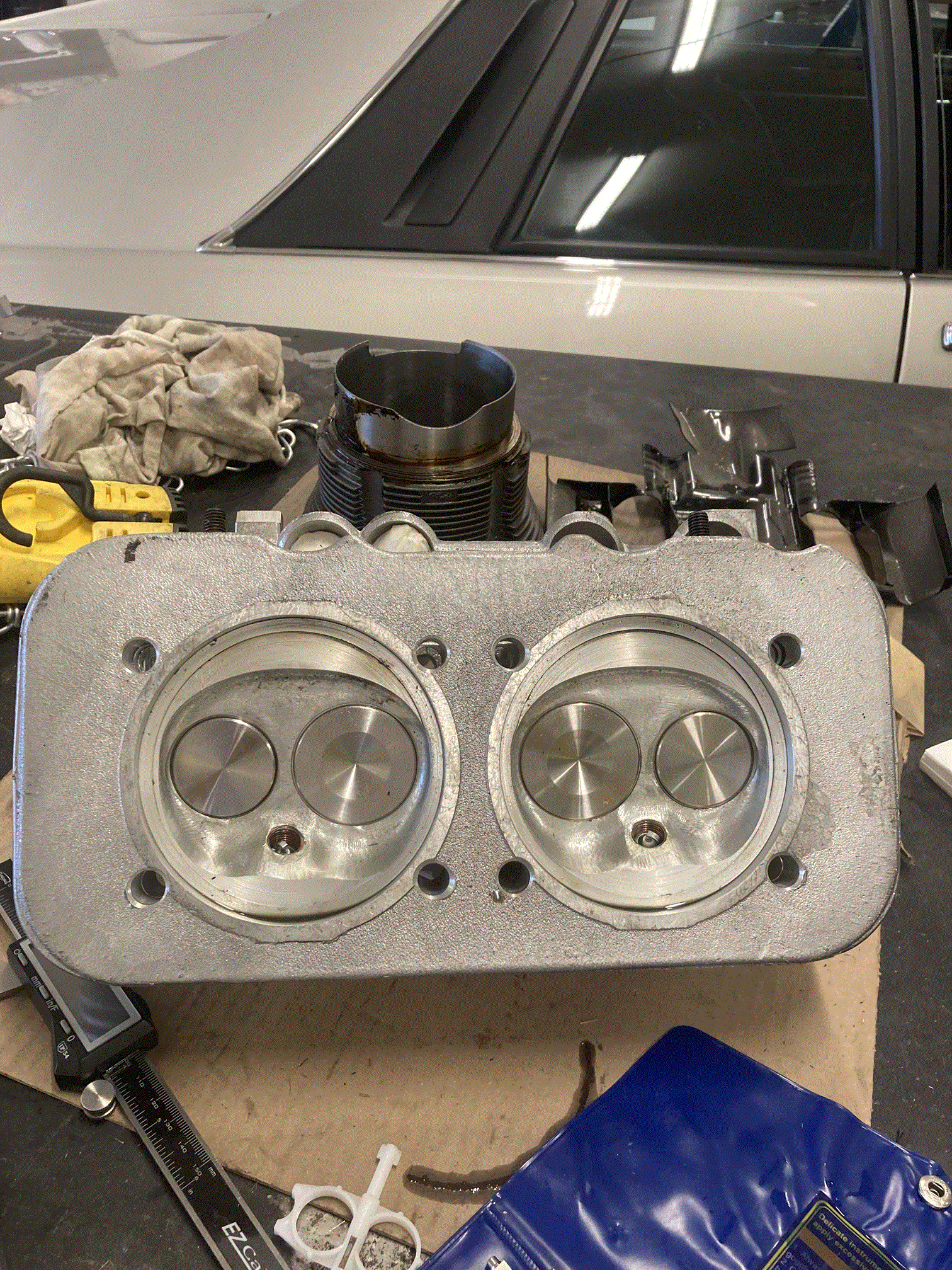

technicalninja   Positives: Heads- look like Raby heads with weldin...   Jul 10 2024, 07:26 PM

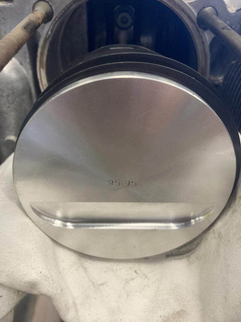

technicalninja   95.95mm in a 96mm bore equals .05mm PTW clearance ...   Jul 11 2024, 07:26 AM
Superhawk996   95.95mm in a 96mm bore equals .05mm PTW clearance...   Jul 11 2024, 08:10 AM
Robroe   95.95mm in a 96mm bore equals .05mm PTW clearance...   Jul 11 2024, 11:33 AM

technicalninja   [quote name='technicalninja' post='3155978' date=...   Jul 11 2024, 11:25 AM
technicalninja   Piston to wall Bore clearance. You measure the bo...   Jul 11 2024, 11:48 AM
930cabman   Piston to wall Bore clearance. You measure the b...   Jul 11 2024, 12:14 PM
Robroe   Piston to wall Bore clearance. You measure the ...   Jul 11 2024, 06:49 PM

technicalninja   Those have had the chambers worked far more than S...   Jul 11 2024, 07:22 PM
Superhawk996   Those have had the chambers worked far more than ...   Jul 11 2024, 07:35 PM

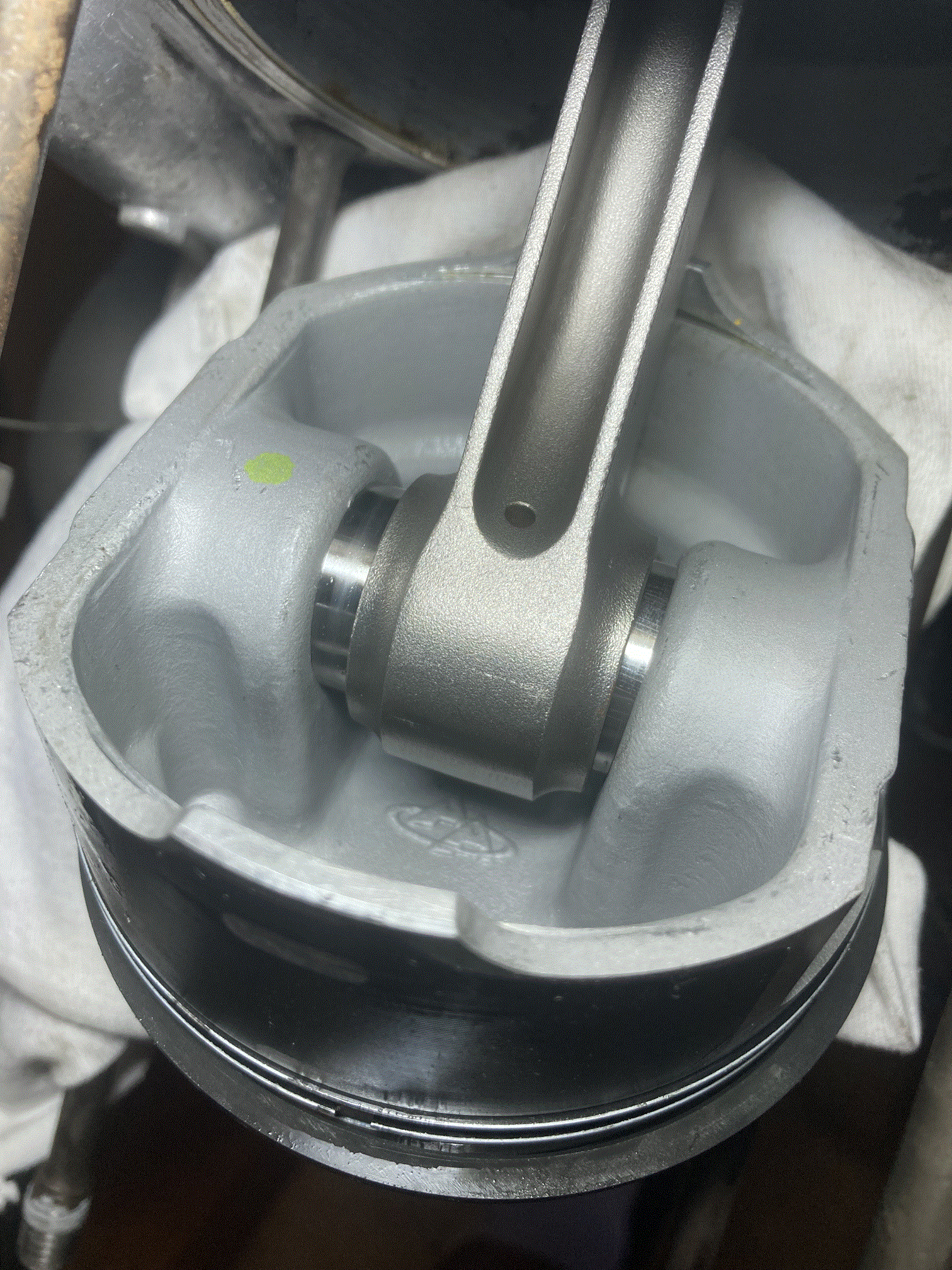

Superhawk996   So lighter than OEM con rods. Looking good. Pi...   Jul 11 2024, 07:27 PM

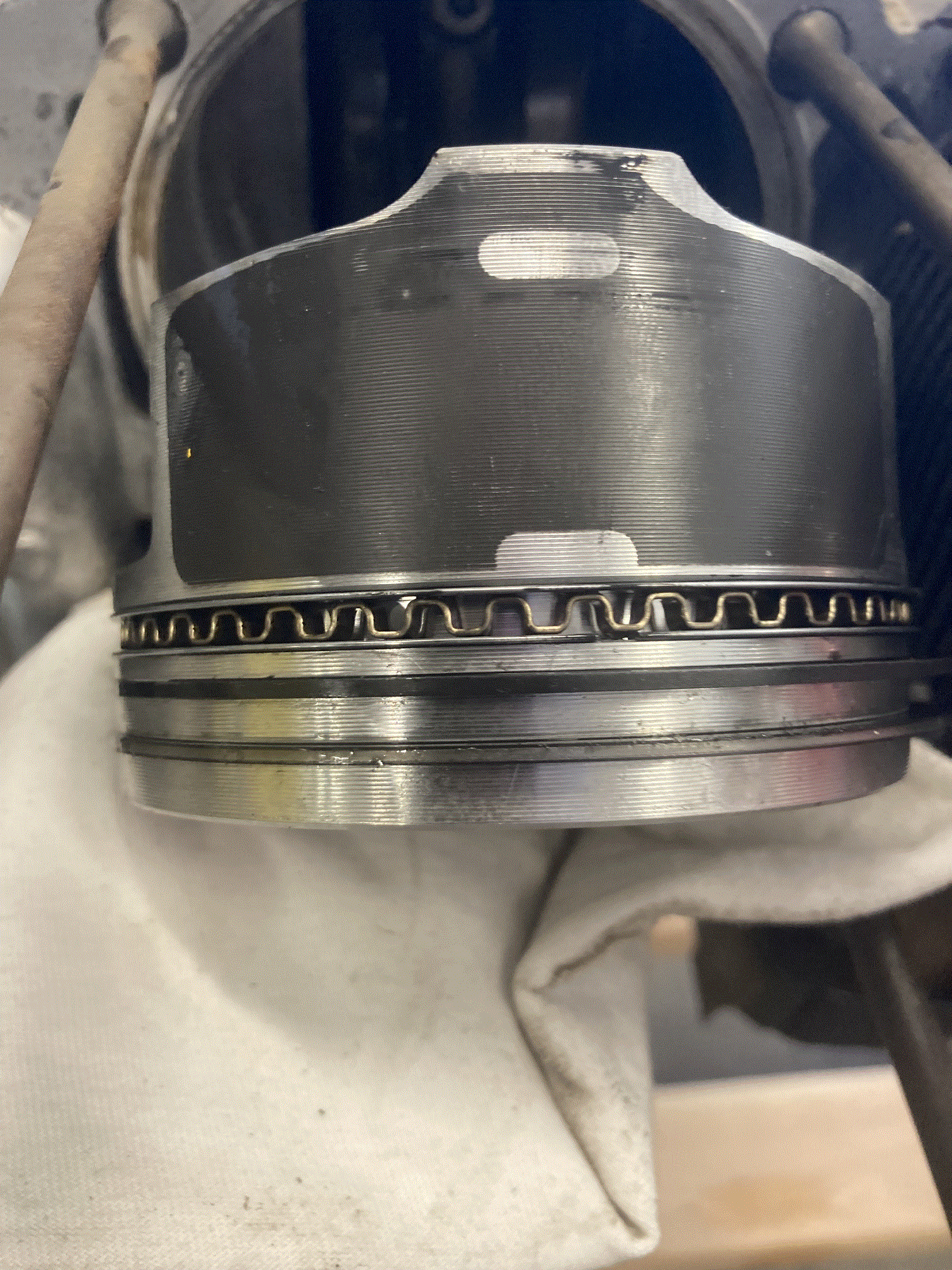

technicalninja   The cast pistons, which I agree are FINE, need cle...   Jul 11 2024, 07:32 PM
technicalninja   Those have had the chambers worked far more than...   Jul 11 2024, 07:46 PM
