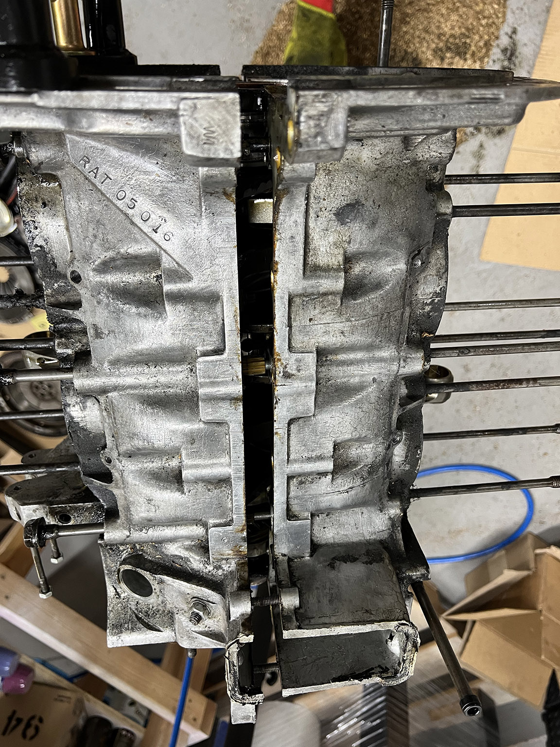

@technicalninja
Picture of RAT case with Serial number
Just so all can see what one of these RAT cases done my Jake looks like
Best Bob B

technicalninja   Good looking numbers! I'd pick a single s...   Jul 12 2024, 05:08 PM
Robroe   Good looking numbers! I'd pick a single ...   Jul 12 2024, 06:25 PM
Superhawk996   I need an engine stand yoke for my build. My wel...   Jul 12 2024, 08:23 PM
technicalninja   I bought a cheap ass one as I was NOT planning on ...   Jul 12 2024, 08:45 PM
technicalninja   https://aapistons.com/products/bench-mount-...AiAB...   Jul 12 2024, 08:48 PM
technicalninja   On balancing... Pistons/rods I will balance to +/...   Jul 13 2024, 10:26 AM
Robroe   On balancing... Pistons/rods I will balance to +...   Jul 13 2024, 02:11 PM
930cabman   [quote name='technicalninja' post='3156410' date=...   Jul 13 2024, 05:51 PM
technicalninja   Thanks for the pics! Those ridges in the port...   Jul 13 2024, 02:29 PM
emerygt350   It looks like a ton of work for a little old 4, te...   Jul 14 2024, 04:46 AM
