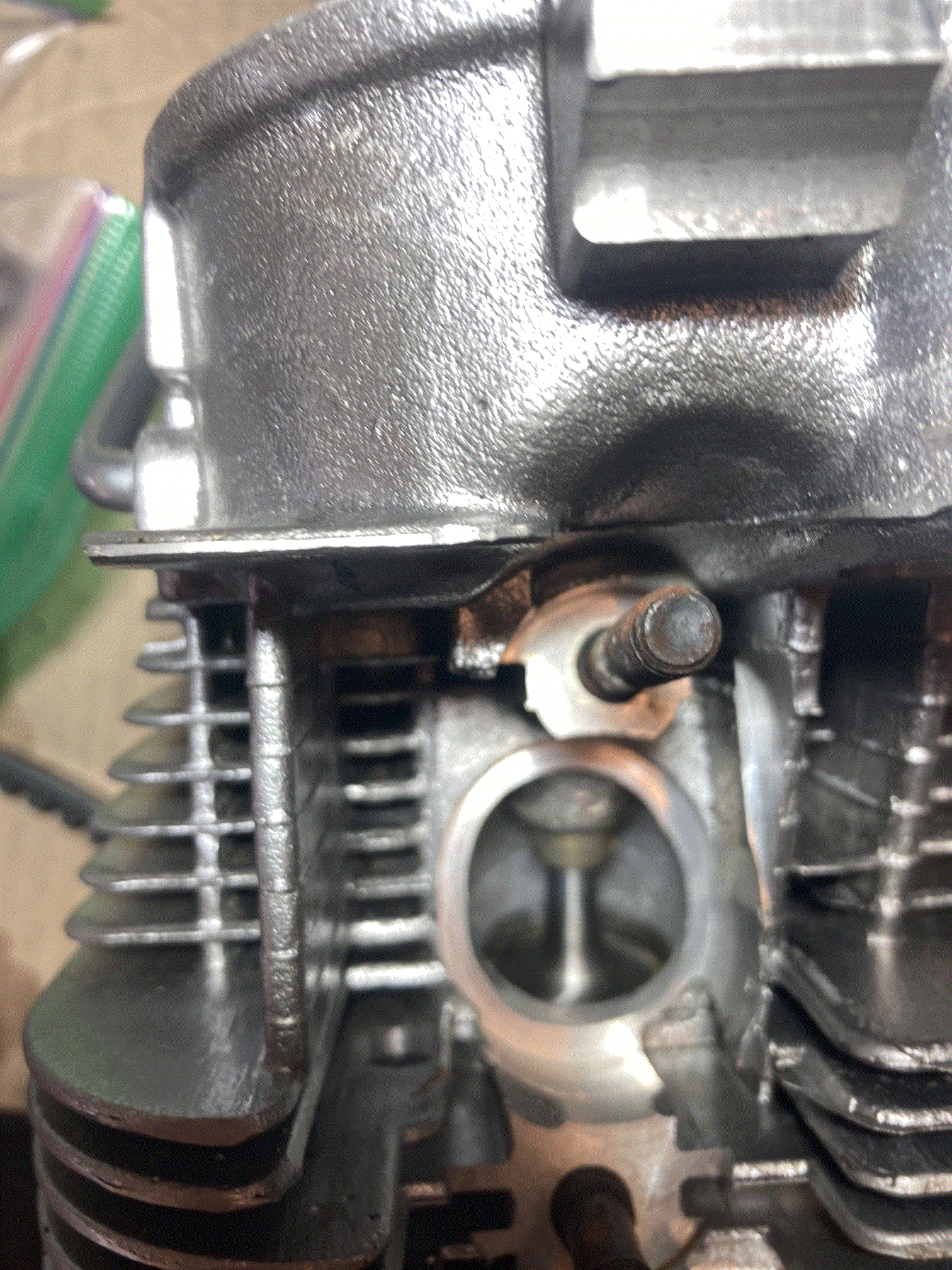

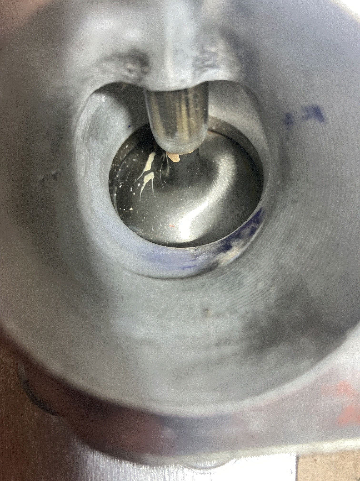

Robroe   Here are measurements so far. I still need cam li...   Jul 12 2024, 04:51 PM
technicalninja   Good looking numbers! I'd pick a single s...   Jul 12 2024, 05:08 PM
Robroe   Good looking numbers! I'd pick a single ...   Jul 12 2024, 06:25 PM

technicalninja   Thanks for the pics! Those ridges in the port...   Jul 13 2024, 02:29 PM
