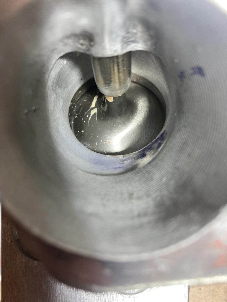

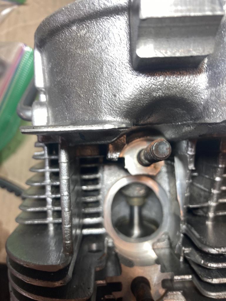

technicalninja   THAT LOOKS PROMISING! You might have hit a ho...   Jul 9 2024, 04:29 PM

technicalninja   You couldn't have any better markings than tha...   Jul 9 2024, 06:28 PM

technicalninja   Positives: Heads- look like Raby heads with weldin...   Jul 10 2024, 07:26 PM

technicalninja   Thanks for the pics! Those ridges in the port...   Jul 13 2024, 02:29 PM
