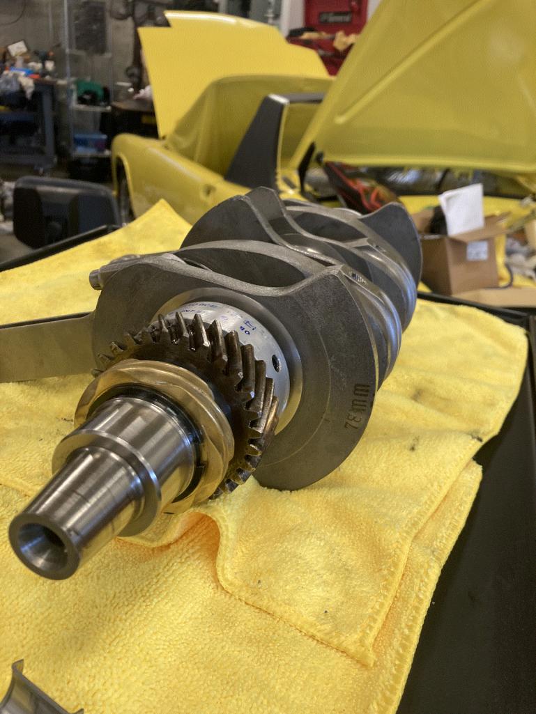

The crank movement was large and loud. I could measure it with my tape measure. I would have preferred the little click. Was hoping I was wrong too.

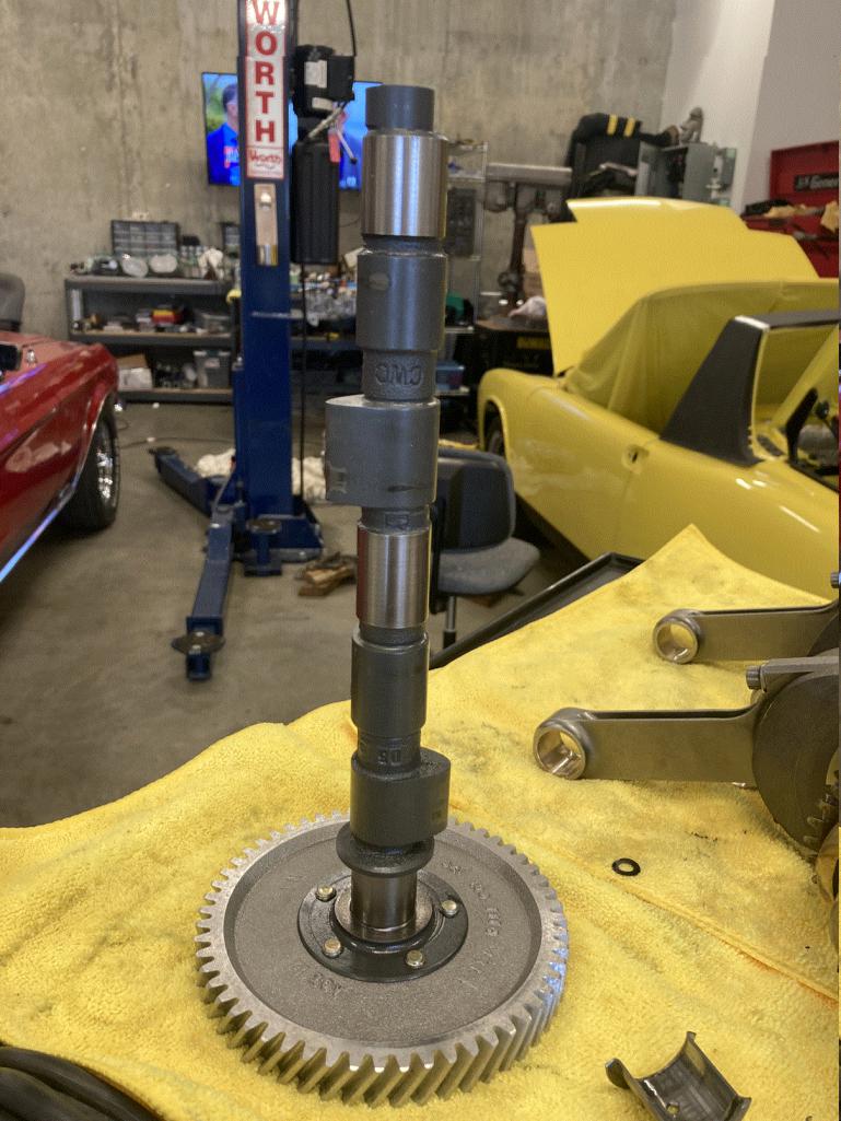

Got the case split today thanks to your help. The cam and lifters are a Webcam Raby 2500. Crank is marked 78 mm and stamped 106299 on one of the counterbalances. The rods are marked VW 5.158".

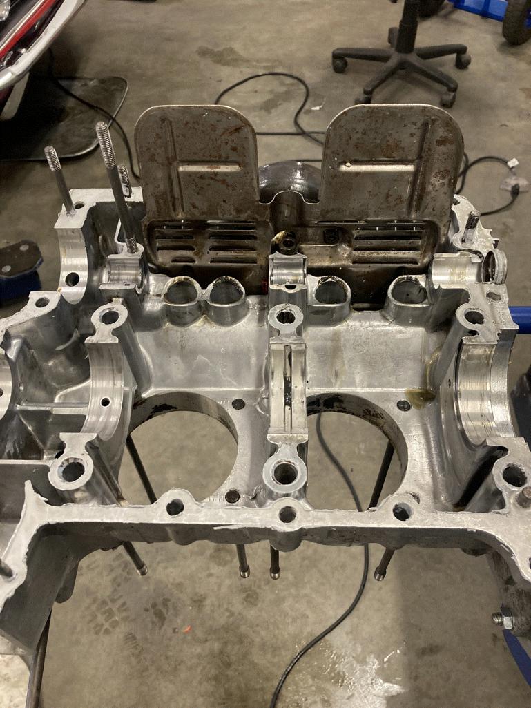

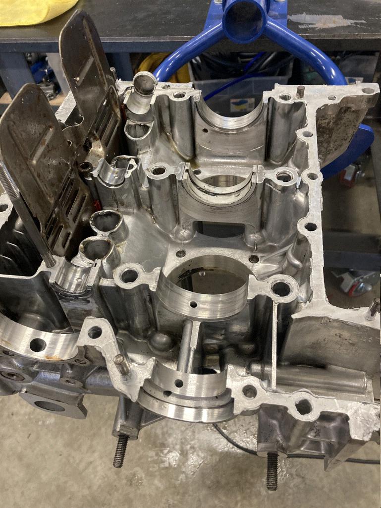

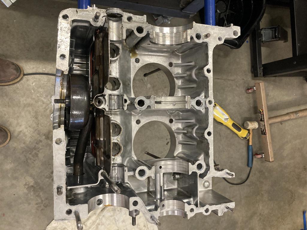

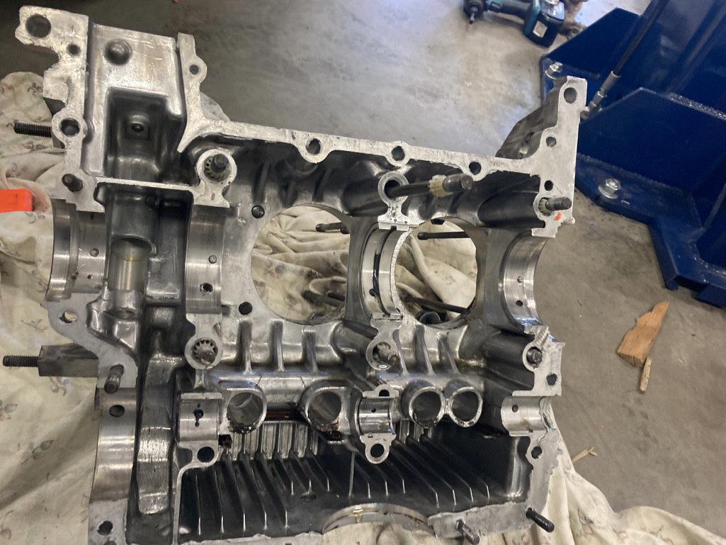

Case pictures.
Attached Image Attached ImageAttached ImageAttached Image

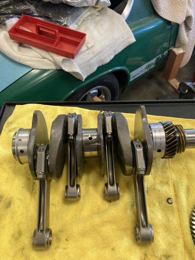

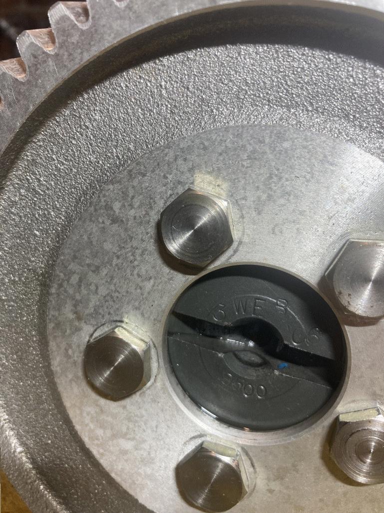

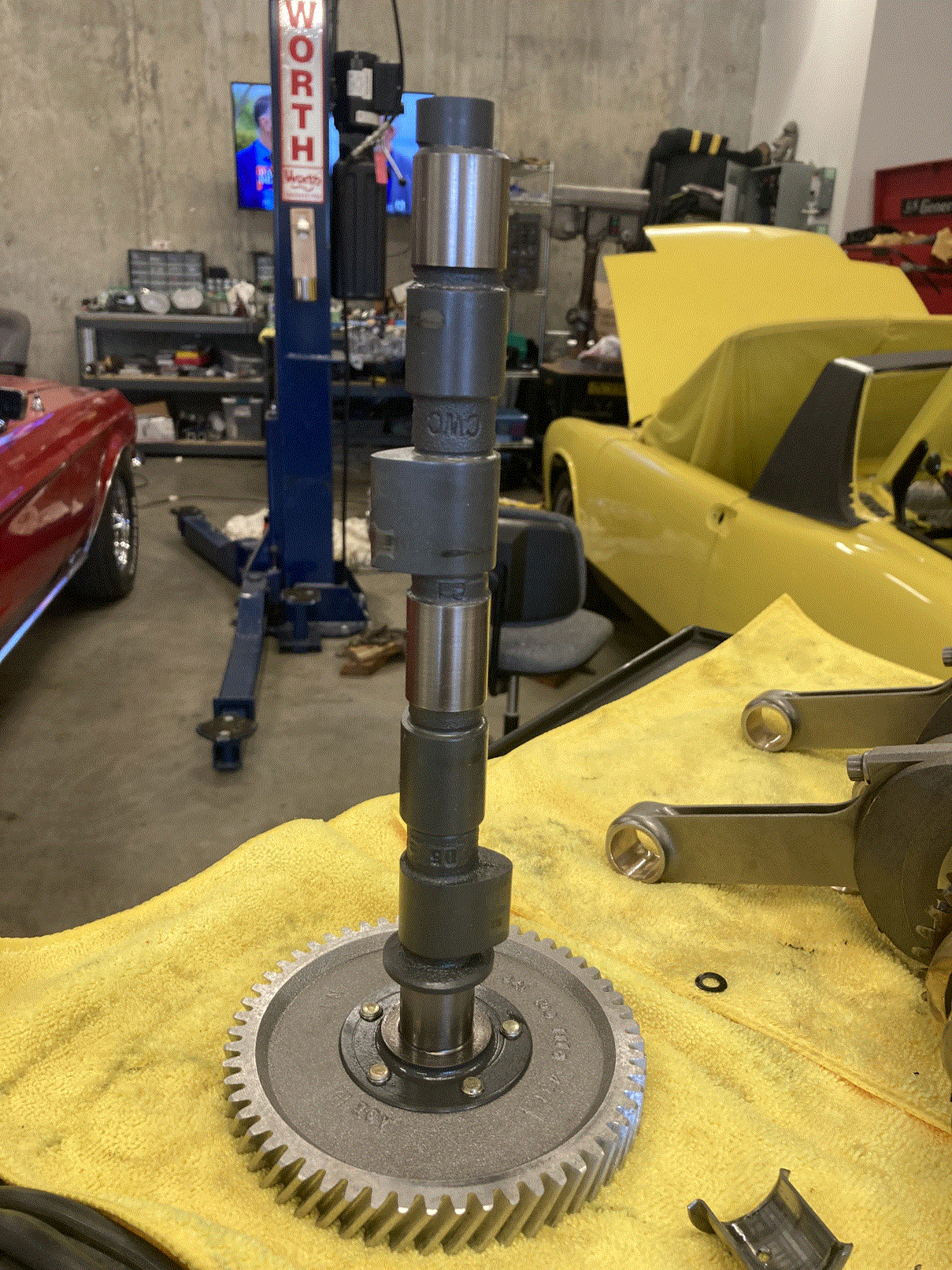

Crank and Cam Pictures

Superhawk996   :trophy: Well the good news is that the internals...   Jul 26 2024, 11:06 AM
Superhawk996   From pictures I’m don’t think I see the Raby R...   Jul 26 2024, 11:13 AM
Robroe   From pictures I’m don’t think I see the Raby ...   Jul 26 2024, 06:57 PM
Superhawk996   Personally, I’d check at least one rod for clear...   Jul 26 2024, 11:20 AM
technicalninja   I'd rattle all of the rods back and forth. Ge...   Jul 26 2024, 11:38 AM
rhodyguy   With the internal oil baffles, a newer 2.0 case? W...   Jul 26 2024, 02:15 PM
technicalninja   His case has the thicker case registers. That par...   Jul 26 2024, 02:44 PM
914sgofast2   In looking at the cam, I noticed that there are no...   Jul 26 2024, 02:53 PM
Superhawk996   In looking at the cam, I noticed that there are n...   Jul 26 2024, 03:30 PM
Superhawk996   Previous post does being up valid topic though. W...   Jul 26 2024, 03:59 PM
