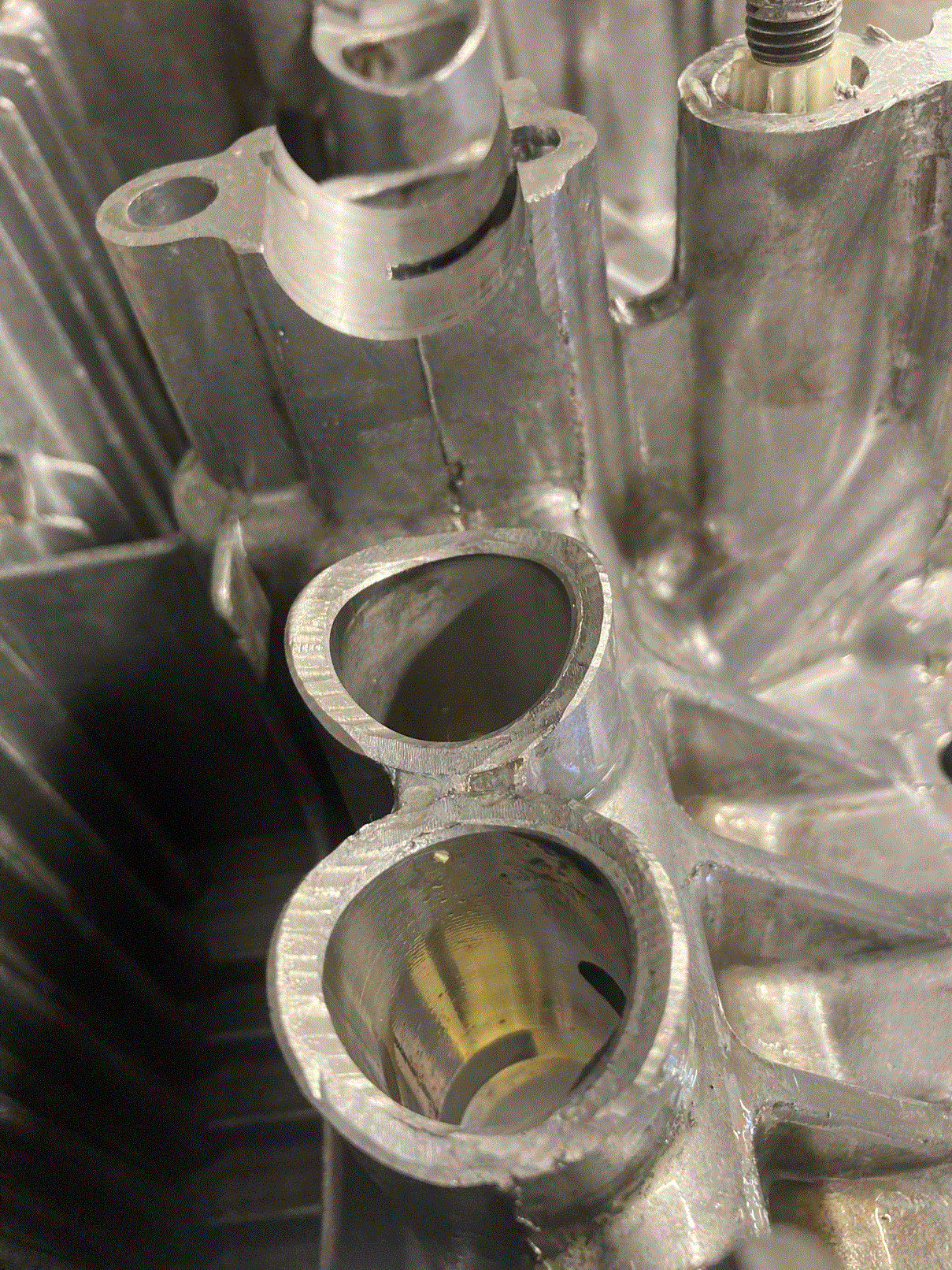

Case pictures.

Does this case appear to be clearanced? Attached ImageAttached ImageAttached Image[attachmentid=917

rhodyguy   With the internal oil baffles, a newer 2.0 case? W...   Jul 26 2024, 02:15 PM
technicalninja   His case has the thicker case registers. That par...   Jul 26 2024, 02:44 PM

Jack Standz   Anyone have an idea what the hole (the one drilled...   Aug 1 2024, 09:41 AM
