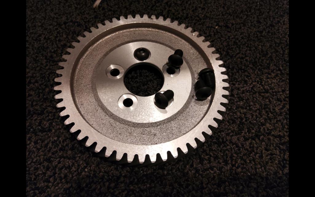

You gave a photo of the cam gear and fasteners. Here it looks like you should spend some time. The cam bolts can hit the oil pump. Included here is a photo of a cam gear with clearance fastener pockets and low profile heads. Best to use loctite.
And check the backside of the cam bolts to case clearance. If too long they can contact the case, so shorten them.
