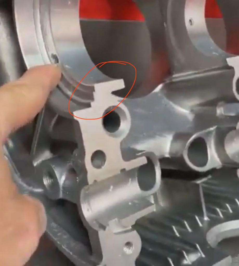

What I haven't see yet is "what does the other case side look like?"
Does Raby do the groove on both cases?
I don't know!
The groove is pretty big as is.
If that was the only thing the case needs, I'd do that mod by hand with a triangle file.
There's another "gotcha" out there as well...
Lots of folks have posted about the quality of the current crop of RMS.
Common gripes are "The molds are old, and the seals are less likely to work."
I haven't seen "Use this brand and you'll be OK" yet...
So, if I was trying to make a RMS work in a T4 today I'd be looking for NOS old shit.
You've already seen one super nice thing about SH...
I posted the video, but he posted "best time to look" is 11:55.
He can be far more precise than me about exactly what to look at.
Saves TIME!
Now the whole video is worth watching a few times.
When I went back and checked 11:55 I saw something I missed the first time around.
I have late cases and the video states late cases need bigger groves!!!
Not sure how I missed that but thanks @Superhawk996

No. In the video the groove is only in one side only (mating side from video below)
I suspect it isn’t hugely critical. My guess is that it’s only in one side because . . . Why set up in the mill twice and go to the trouble to match the position between case halves.
Just trying to get a lower alternative path to bleed out some additional oil below the OEM drain.
