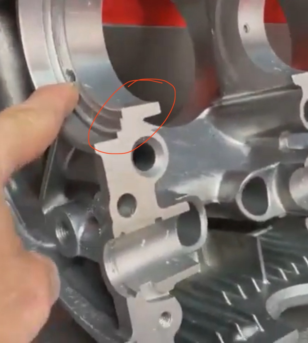

What I haven't see yet is "what does the other case side look like?"
Does Raby do the groove on both cases?
I don't know!
The groove is pretty big as is.
If that was the only thing the case needs, I'd do that mod by hand with a triangle file.

When I went back and checked 11:55 I saw something I missed the first time around.
I have late cases and the video states late cases need bigger groves!!!
Not sure how I missed that but thanks @Superhawk996

No. In the video the groove is only in one side only (mating side from video below)
I suspect it isn’t hugely critical. My guess is that it’s only in one side because . . . Why set up in the mill twice and go to the trouble to match the position between case halves.
Just trying to get a lower alternative path to bleed out some additional oil below the OEM drain.

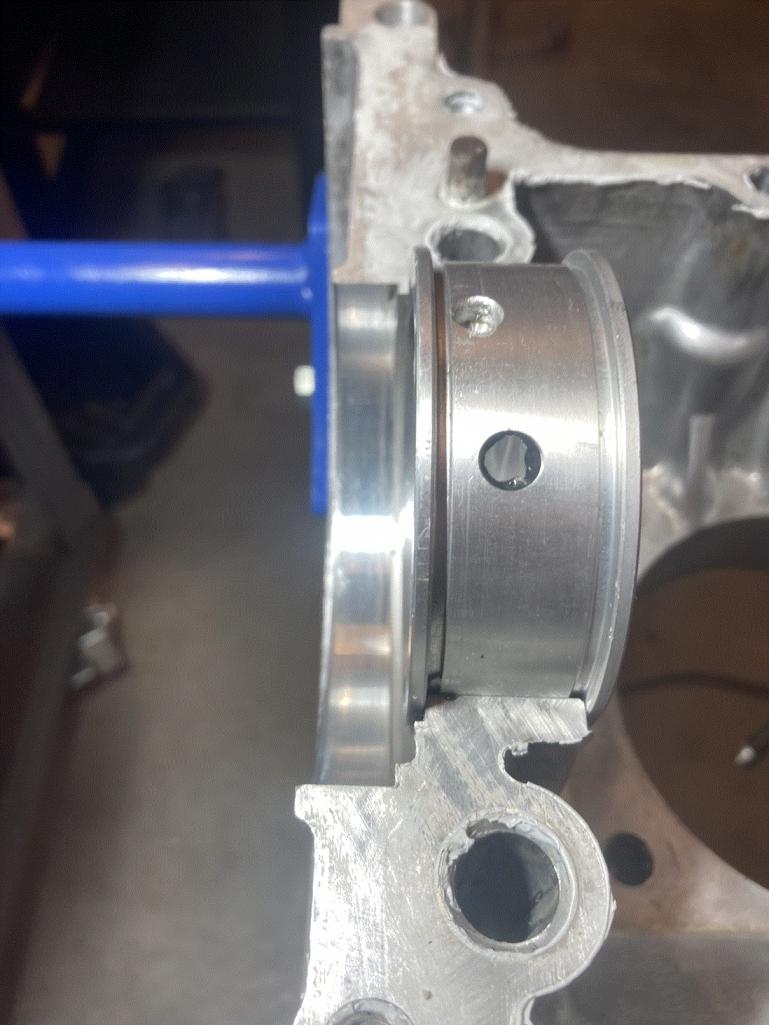

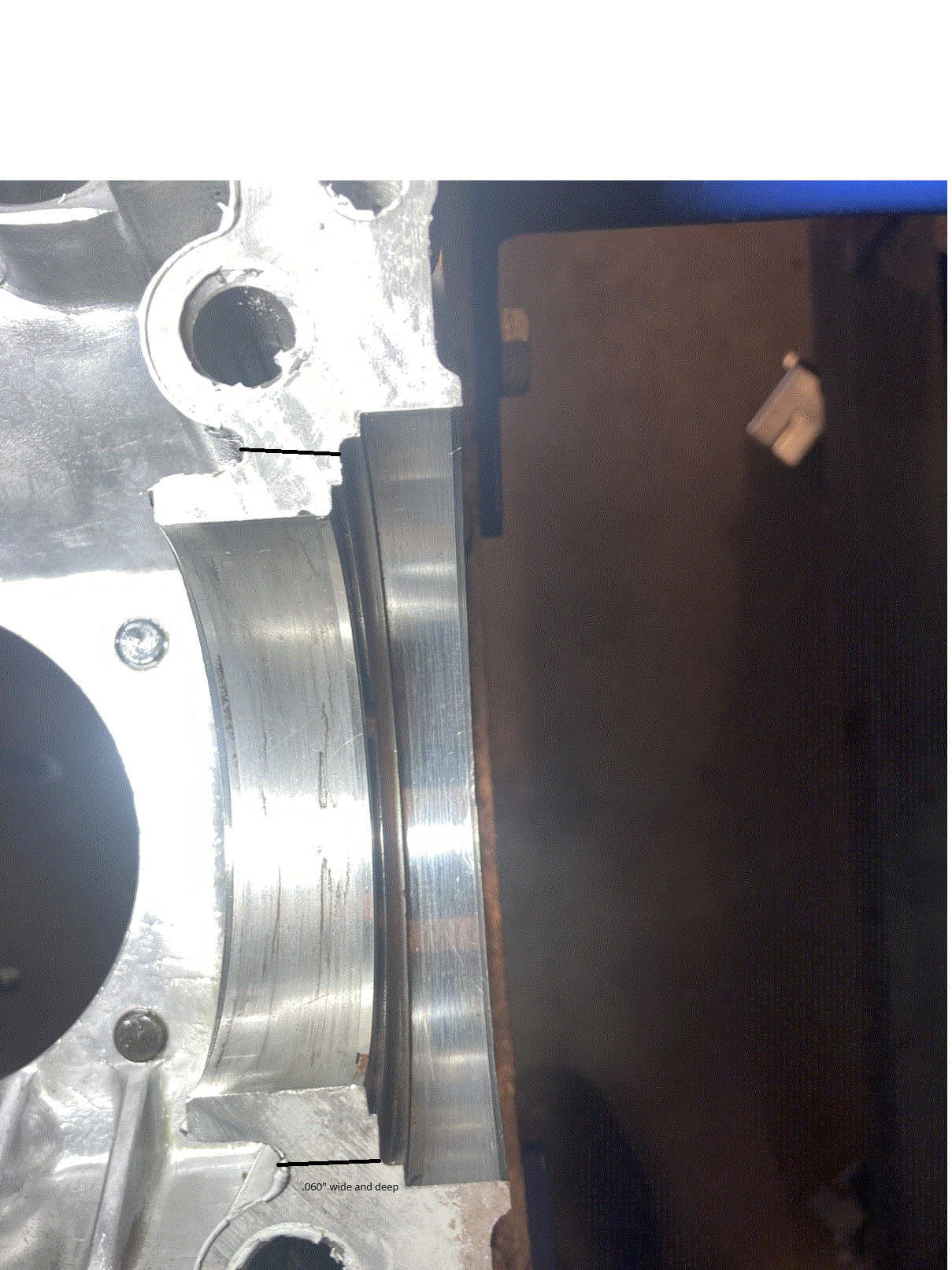

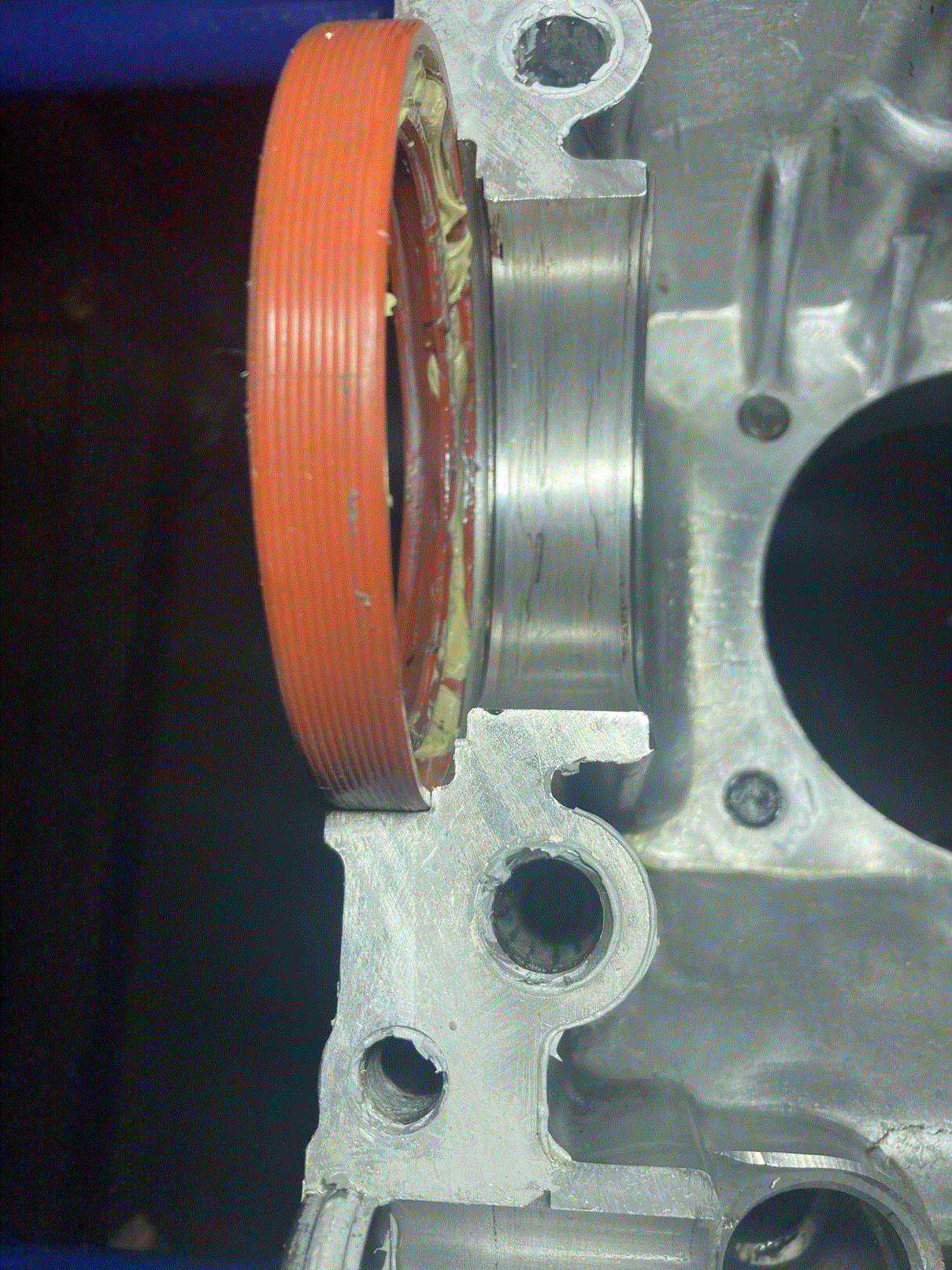

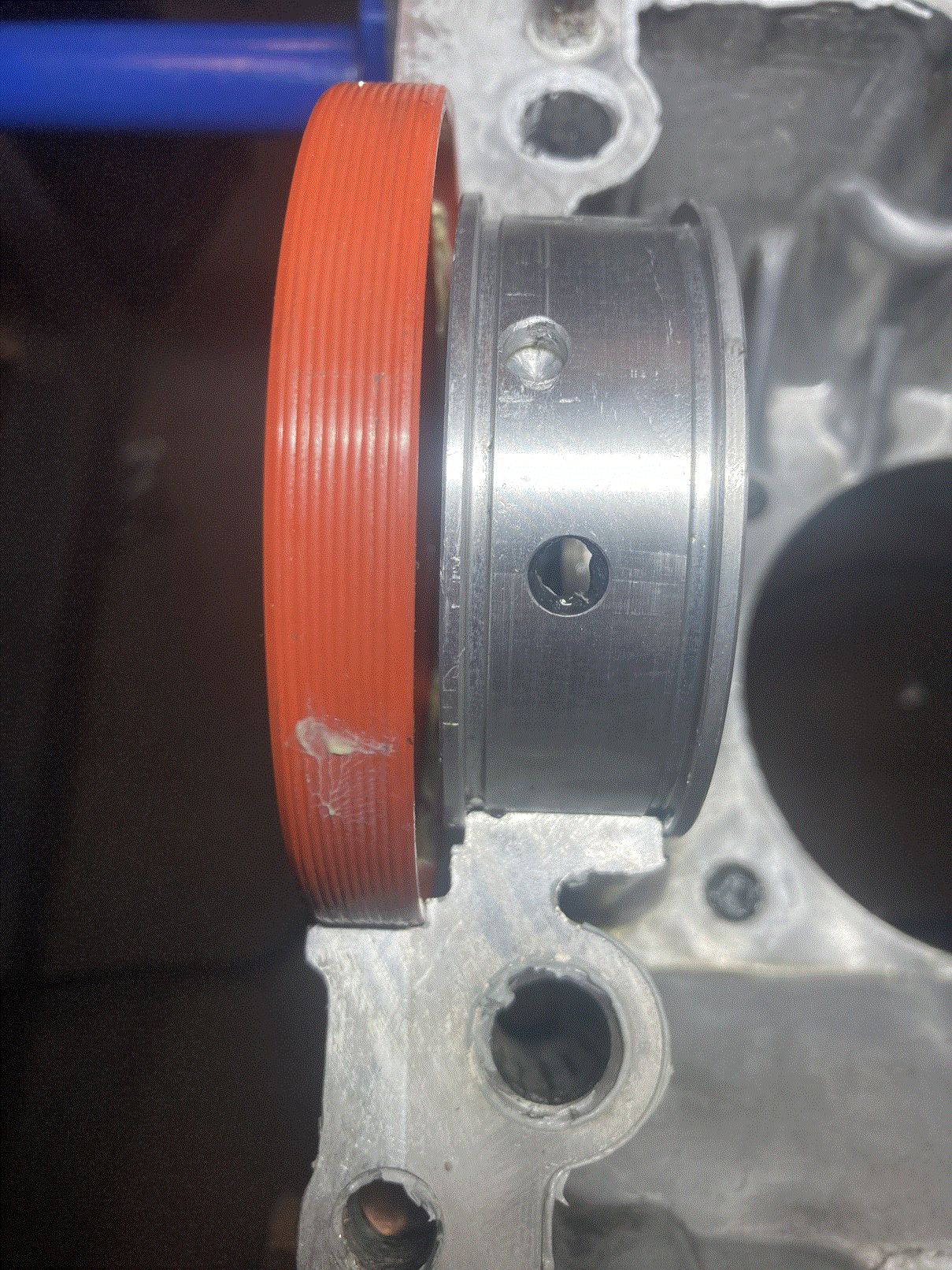

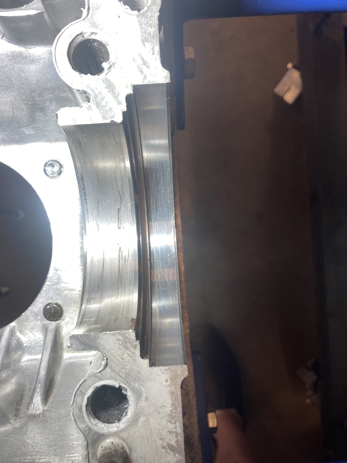

Here are close up picts of the RMS and Rear main bearing test installed to get a better understanding of the RMS leak back mod to avoid oil trapped too high behind the seal causing RMS leaks. Please see my feeble attempt at drawing a line where the groove is cut in the lower case. With the RMS and bearing installed, you can see the proper place to cut the groove between the seal and bearing on either side of the RMS. I heard .060" for width and depth. Is that correct? Should I really do it myself with a triangle file or a Dremel? Or should I ask the local small townAttached ImageAttached ImageAttached Image[attachmentid
=917843]Attached Image machine shop to cut it more precisely than I could. Thanks very much! Starting to get to know you guys and definitely appreciate and depend on your input. Thanks!
