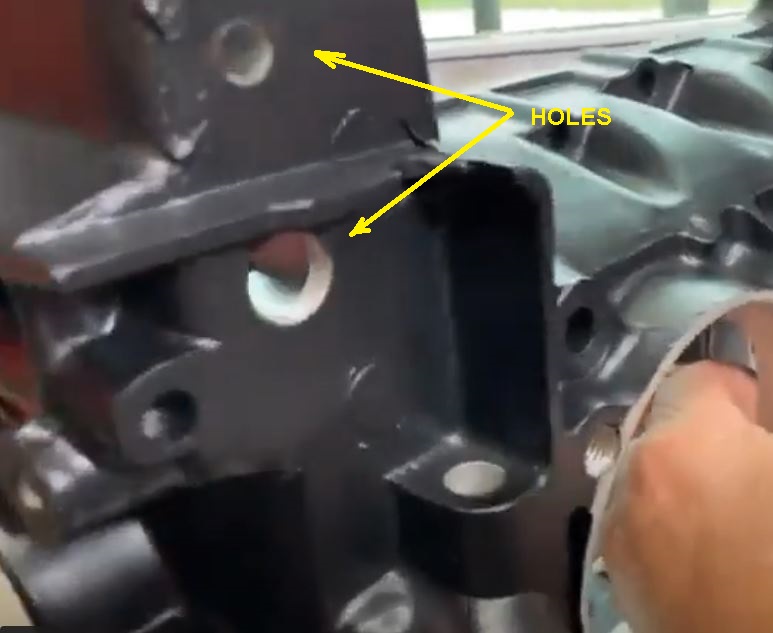

914Werke - can a newbie ask a dumb question? What do the holes shown in your photo do? Does this have something to do with RMS leak prevention?

technicalninja   A few times in that vid you can see big ass holes ...   Jul 26 2024, 07:59 PM
Superhawk996   A few times in that vid you can see big ass holes...   Jul 26 2024, 09:26 PM
914werke   7:38 you can see 2 holes on the L. side of the fil...   Jul 26 2024, 09:37 PM

Superhawk996   It’s just another oil drain back passage at a l...   Jul 27 2024, 07:39 AM

Robroe   :idea: 914Werke - can a newbie ask a dumb que...   Jul 27 2024, 04:30 PM

Jack Standz   It’s just another oil drain back passage at a ...   Jul 27 2024, 04:26 PM
technicalninja   That pic is from the Jake's crankcase video. ...   Jul 27 2024, 07:32 PM
Robroe   Picture of the grooves to drain pooled oil behind ...   Jul 28 2024, 03:59 PM
