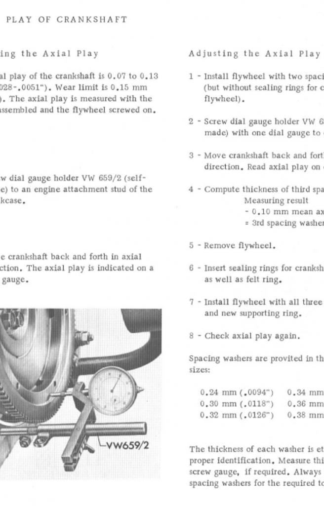

Robroe   Crankshaft end play dilema. When assembled, the c...   Jul 28 2024, 04:13 PM
technicalninja   You're testing it wrong if the flywheel isn...   Jul 28 2024, 05:13 PM
Superhawk996   You’ve got to dig into this - agree with Ninja t...   Jul 28 2024, 05:54 PM
Superhawk996   Note: be careful with that woodruff key in the cr...   Jul 28 2024, 06:04 PM
technicalninja   I think he's doing it wrong, but I do have a q...   Jul 28 2024, 06:09 PM
Superhawk996   Why only three shims? "No less no more...   Jul 28 2024, 06:43 PM
technicalninja   @Robroe Was the flywheel bolted to the motor whe...   Jul 28 2024, 06:16 PM
Robroe   [b]@[url=http://www.914world.com/bbs2/index.php?s...   Jul 28 2024, 08:12 PM
technicalninja   Most important! The method you are using to d...   Jul 28 2024, 06:30 PM
Superhawk996   In defense of measuring off flywheel end. I like ...   Jul 28 2024, 06:51 PM
technicalninja   Thinking about it he could do the exact same thing...   Jul 28 2024, 06:56 PM
Superhawk996   Yup always multiple ways to do it. As long as i...   Jul 28 2024, 07:04 PM
technicalninja   Robroe, we need pictures: do multiangle shots if p...   Jul 28 2024, 07:22 PM
Robroe   Robroe, we need pictures: do multiangle shots if ...   Jul 31 2024, 12:57 PM
technicalninja   Tip for bearing indexing: Mark ALL of the rods wi...   Jul 28 2024, 08:48 PM
technicalninja   Have the next question regarding the CS end play i...   Jul 28 2024, 09:41 PM
Robroe   Did another mock up today to remeasure crank end p...   Jul 29 2024, 09:01 PM
technicalninja   Target DOWN! Glad it's working out! ...   Jul 29 2024, 09:10 PM
