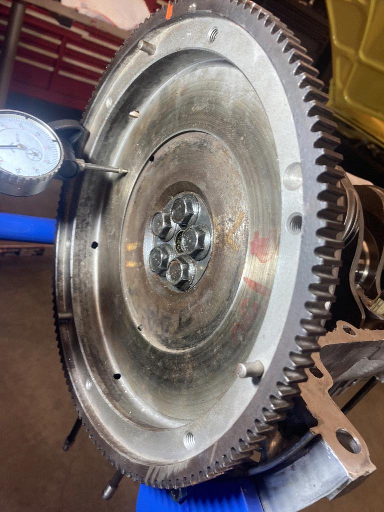

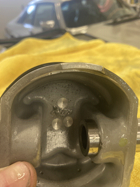

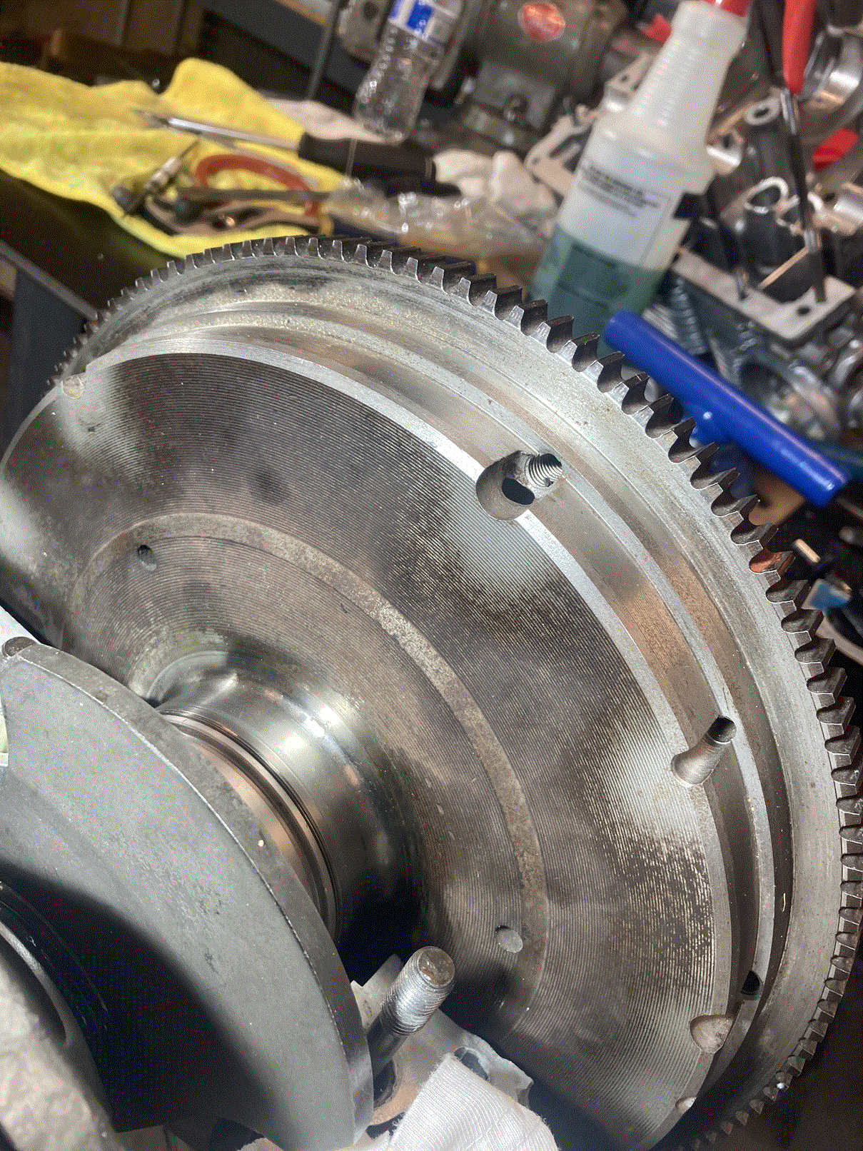

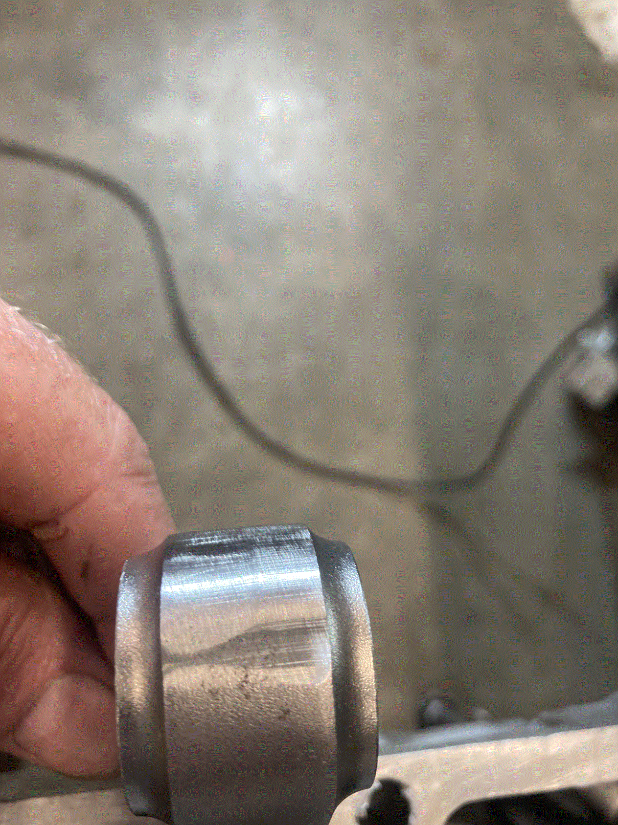

Did another mock up today to remeasure crank end play. This time I installed the bearing dowels, made sure the crank was fully set and installed the flywheel with no seal and removed the crank o ring. Tightened the crank bolts to around 40lbs. End play was suddenly down to .002"!!!. I must have left the crank bolts too loose previously so got bad measurements as y'all suspected. I feel confident that I can assemble and adjust to .004" with available shims. See Pict of measurements.
Also checked for signs of balancing. The rods show signs of minor grinding to remove metal and pistons have drill head marks also showing signs of removing metal. Looks like I'm in the clear to move on to cleaning, getting gasket kit and assembly lube/sealants.

technicalninja   Have the next question regarding the CS end play i...   Jul 28 2024, 09:41 PM
Robroe   Did another mock up today to remeasure crank end p...   Jul 29 2024, 09:01 PM
technicalninja   Target DOWN! Glad it's working out! ...   Jul 29 2024, 09:10 PM
technicalninja   It looks like the clutch disc surface has seen rot...   Jul 29 2024, 09:17 PM
