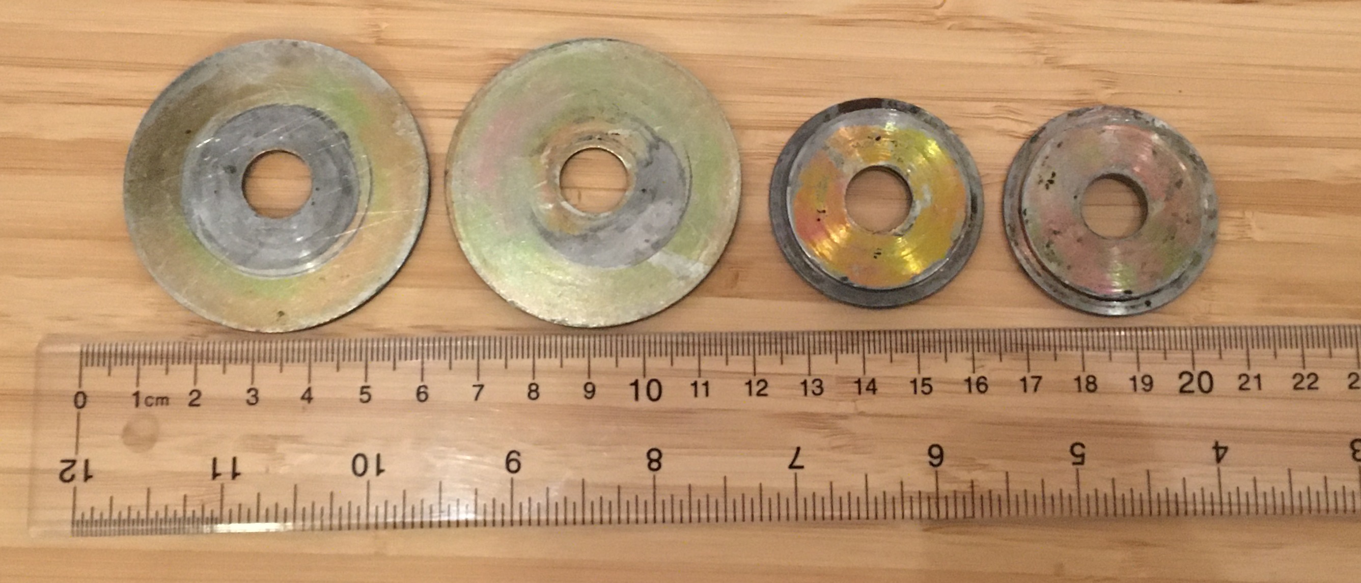

Can anyone tell me the ID, OD, and thickness of the washers used in the rear shock assembly?
The PO of our car swapped out and removed a bunch of stuff. I have a stash of various large washers I can pick through, but can't find specs to know what's correct. They all appear to be NLA, so hard to even find pictures. Are any of these unique in that they're concave or slotted?
  • #4 914-333-503-00 Cap - boge -
  • #5 901-333-511-00 Stop washer
  • #9 914-333-515-01 Washer (aka suspension shim?)
  • #13 914-333-515-00 Washer
Thank you.

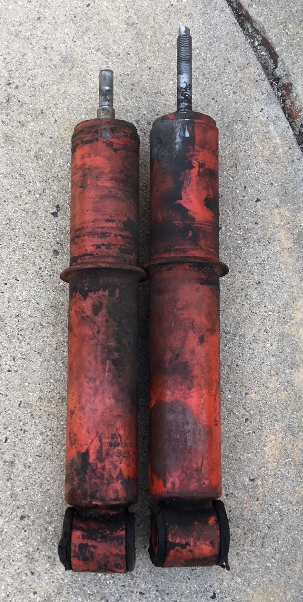

Dennis, I have the two plastic split washers shown in my previous post and I have these (the larger one being the one you wanted dimensions of).
All of this hardware was part of the Koni red shown below:

Montreal914   @DennisV Here is what I measure for #9 (the ones...   Jul 10 2024, 02:03 PM
DennisV   As for washer #5, I am not sure which one it is :...   Jul 10 2024, 04:13 PM
Montreal914   This is the only part that is non-metal in my Koni...   Jul 10 2024, 04:24 PM
Montreal914   Dennis, I have the two plastic split washers shown...   Jul 30 2024, 08:58 PM
