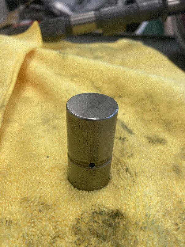

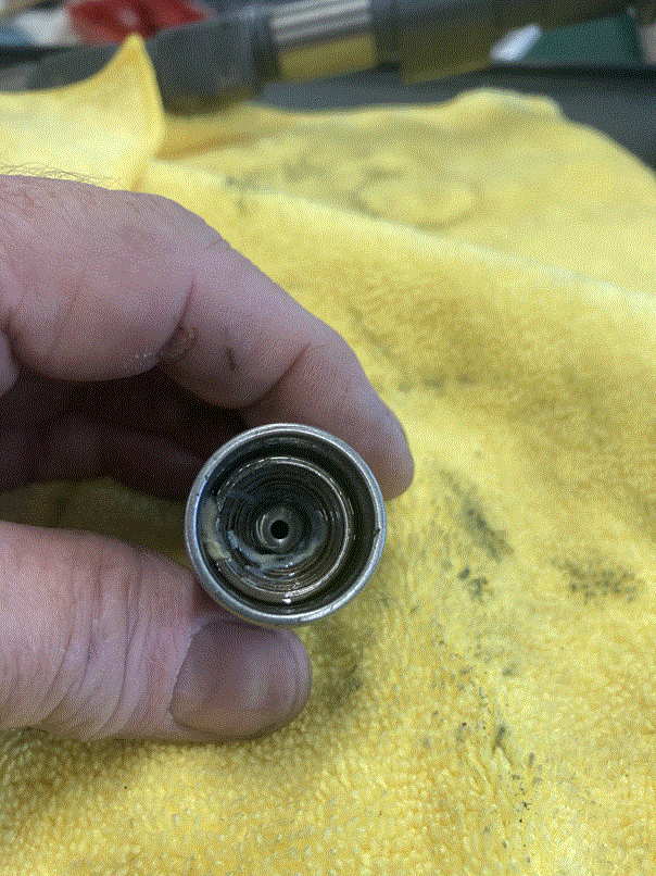

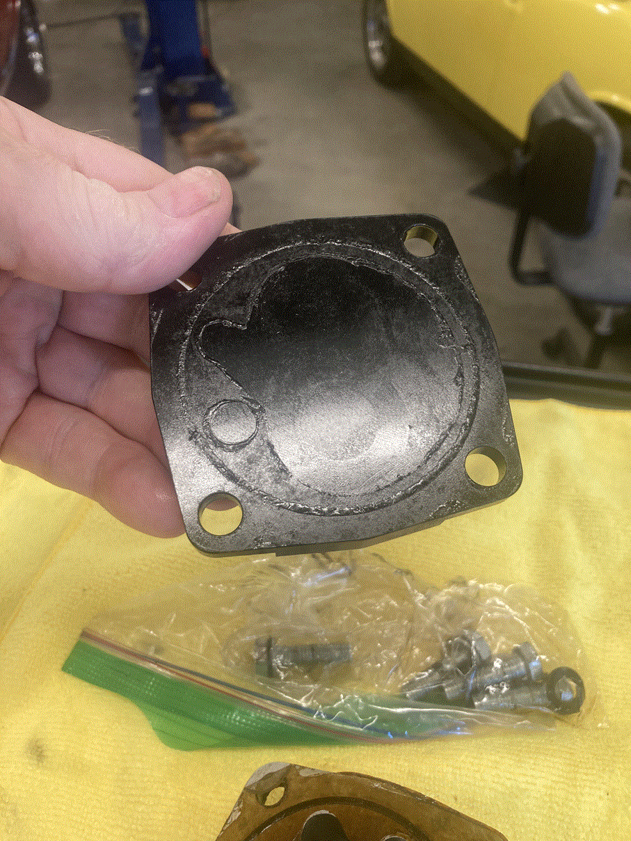

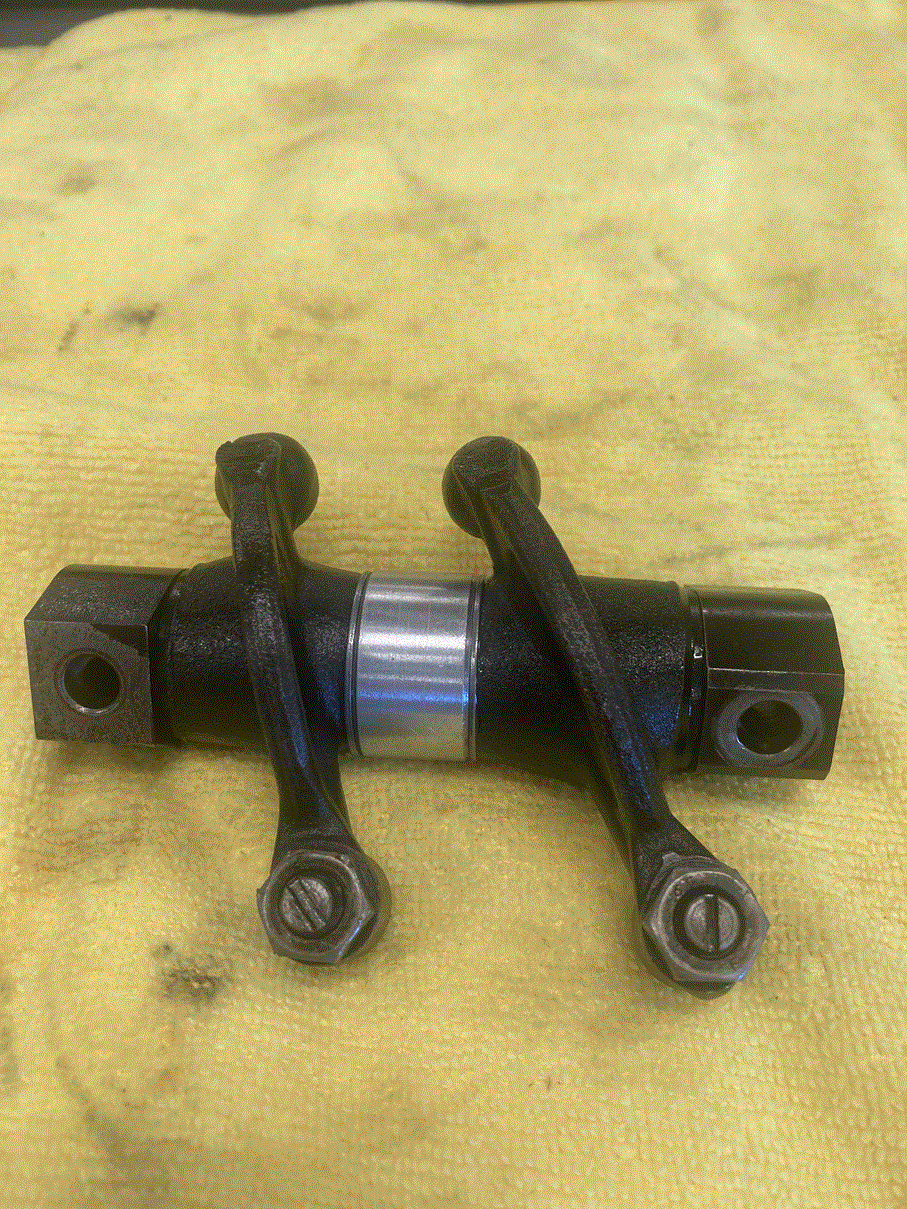

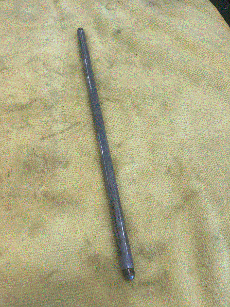

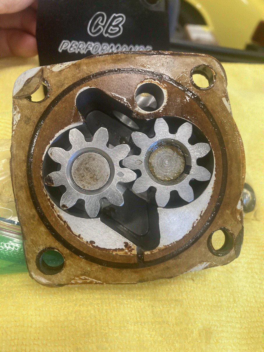

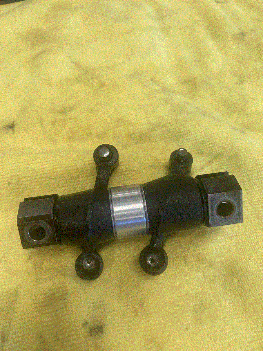

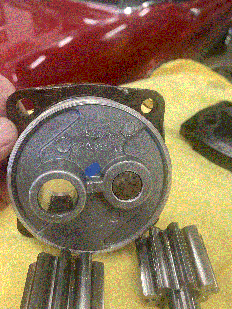

Robroe, we need pictures: do multiangle shots if possible
Oil pump
Rocker arm assemblies
Pushrods
lifters
Are there any fresh drill marks on the crank?
Fresh grinding marks on the rods?
Most of the time balance holes/marks are obvious.
They are not centered, sort of haphazard, and some of them will be STUPID shallow.
What I'm hunting is evidence of balancing...

QUOTE(technicalninja @ Jul 28 2024, 08:22 PM) *
Oil pump
Pushrods
lifters
Piston weights with wrist pins and c clips very close. Obviously balanced. Have not removed rods from crank. Not sure if I should. But they show random grinding marks indicating balancing as does the crank in just a few spots. Here are the picts you specified. Will show piston side view in another post. Thanks so much!
Attached Image Attached ImageAttached ImageAttached Image[attachmentid=918
260]Attached ImageAttached ImageAttached Image Attached Image Attached Image
