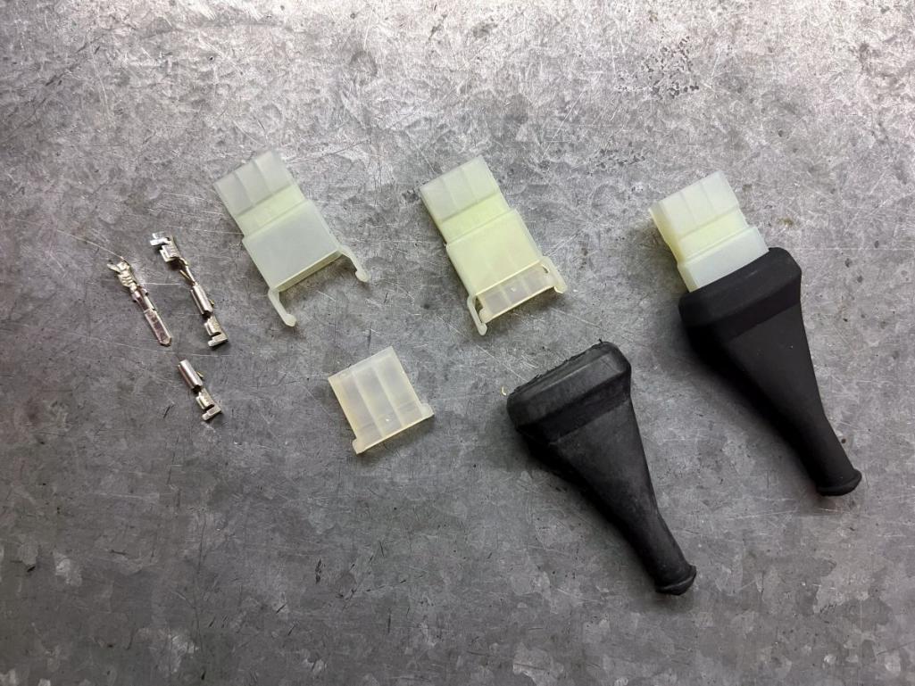

You need to crimp open barrel wire terminals onto the 2 wires on the 123 dizzy for the trigger points. The male terminals in the photo below, which insert into the cavities of the new female housing I am sending you, which mates to the male 3 pole housing on the FI wire harness.
So you need an "open barrel wire terminal crimper tool". You will also need a wire stripper to remove the wire insulation to expose the wire, to install the wire terminal.
