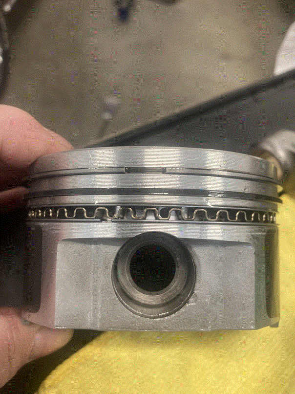

Need a side pic of the piston soon
Many strokers incorporate a pin that bisects the oil control ring groove.
There is a MOSTER CRITICAL mod that has to be done if this is the case.
Not doing it means RAPID failure.
If the pin cuts through the lowest ring land, then a tiny little roll pin needs to be installed to locate the lower oil control ring scrapper OR you assemble an engine that EATS itself in a very short period of time.
If the pin doesn't encroach on the ring land, then a pussy chose the parts and selected a "too short" con rod.
You'll have to use it, but it will be sad.
I am a HUGE believer in installing the longest rod you can jam into any motor.
"LENGTH is IMPORTANT" regardless of what your mental health provider says...

Piston side view Attached Image
