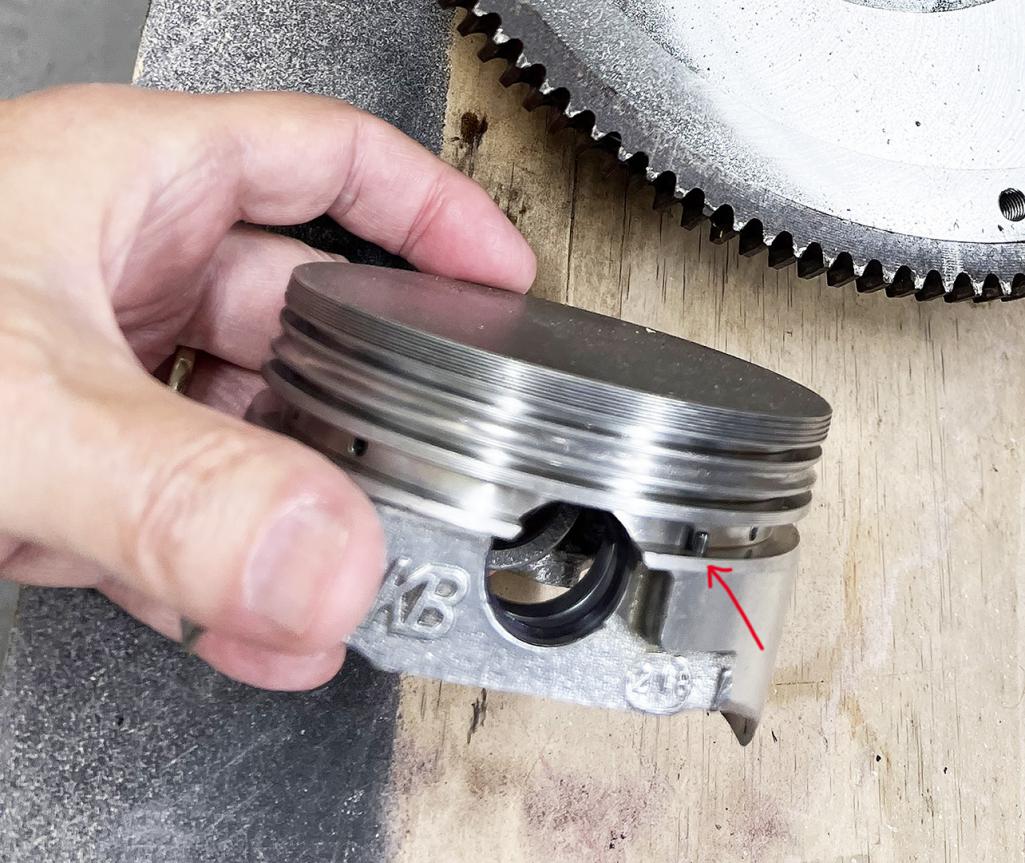

Need a side pic of the piston soon
Many strokers incorporate a pin that bisects the oil control ring groove.
There is a MOSTER CRITICAL mod that has to be done if this is the case.
Not doing it means RAPID failure.
If the pin cuts through the lowest ring land, then a tiny little roll pin needs to be installed to locate the lower oil control ring scrapper OR you assemble an engine that EATS itself in a very short period of time.
If the pin doesn't encroach on the ring land, then a pussy chose the parts and selected a "too short" con rod.
You'll have to use it, but it will be sad.
I am a HUGE believer in installing the longest rod you can jam into any motor.
"LENGTH is IMPORTANT" regardless of what your mental health provider says...

I take a lot of photos and look back on them for reference.
This is one of the Keith Black pistons used in the RAT 2170 build on Marks Eng.
As the Ninga was going over this I thought I would show it
Also, the pistons where used for Harley Davidson strokers
Best Bob b
