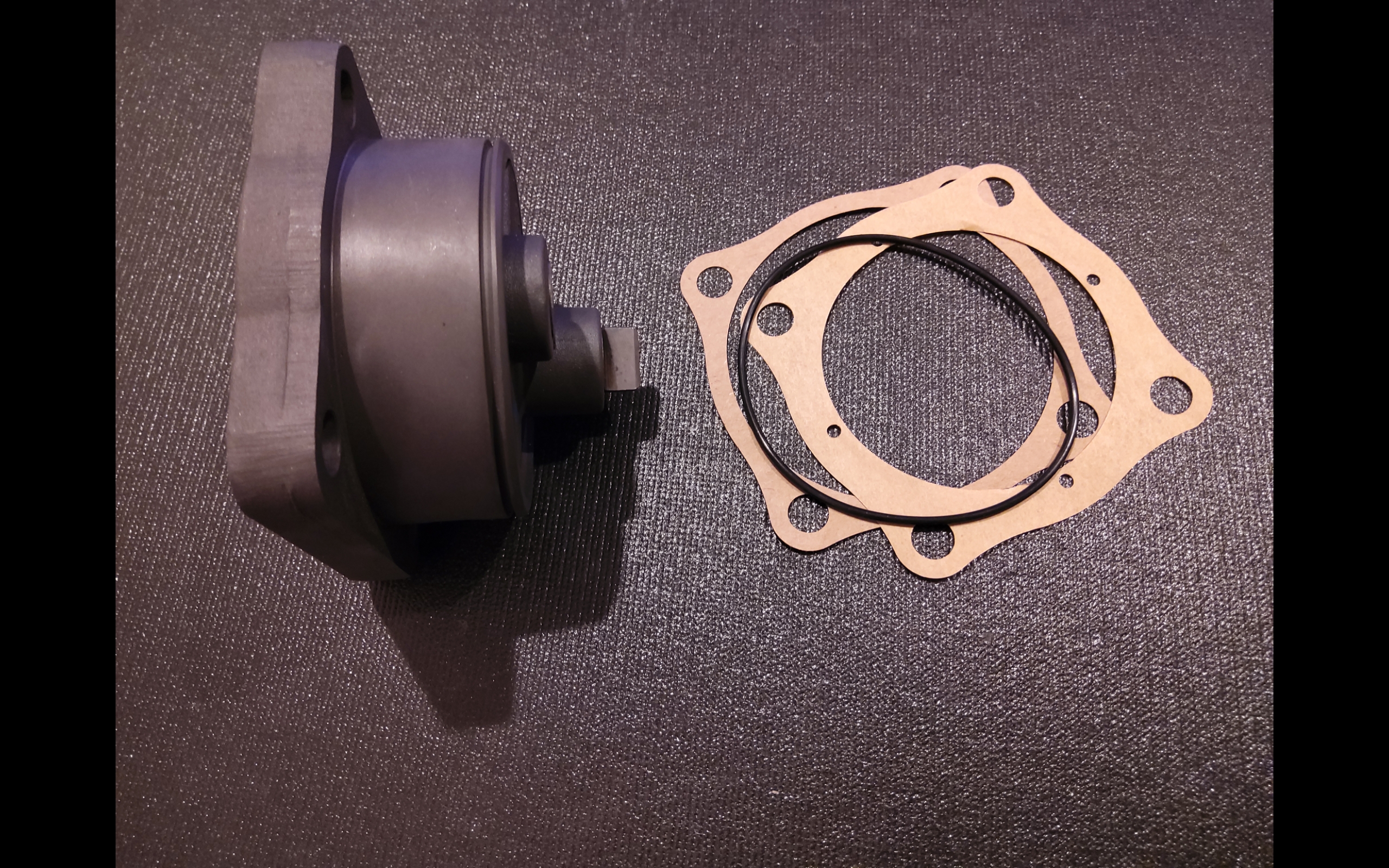

Gene Berg oil pump with o-ring.

Jack Standz   Gene Berg oil pump with o-ring.   Jul 31 2024, 04:15 PM
