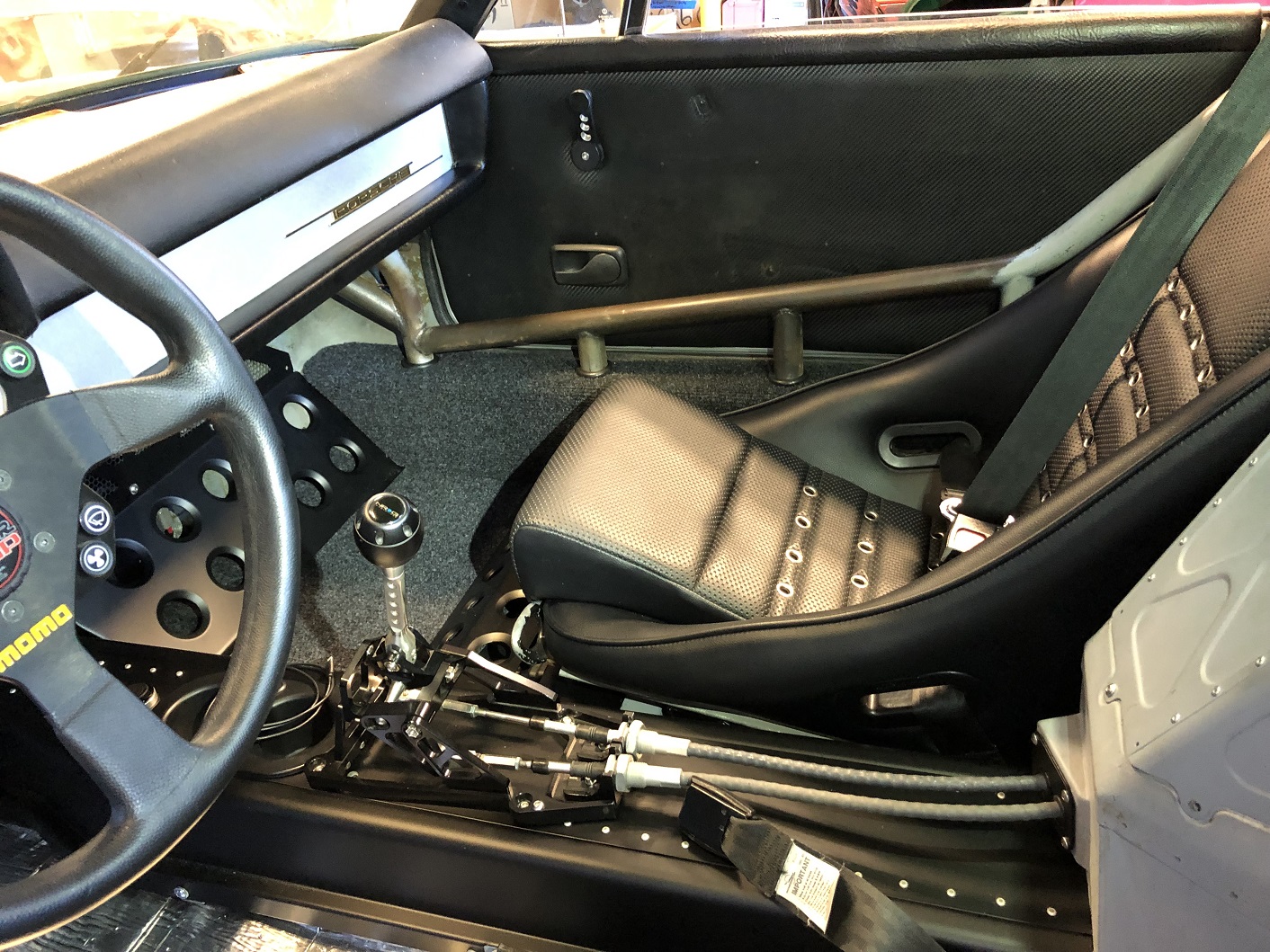

Hey 6-speeders, anyone have photos of how they penetrated the firewall for the shifter cables? Thanks!
@Lof8 - Check out the Renegade Hybrids YouTube videos. They do a review of their install and I believe there are pics of the shifter cable routing. Pretty sure it's through exising holes in the firewall.
I did a completely different thing because I'd built a custom firewall and wanted to feature the shifter and cables. I don't know what clearances your engine provides but maybe you could do something similar.

technicalninja   [b]@[url=http://www.914world.com/bbs2/index.php...   Aug 1 2024, 08:23 AM
ClayPerrine   I ran one of mine through the speedo cable hole, a...   Aug 1 2024, 01:46 PM
