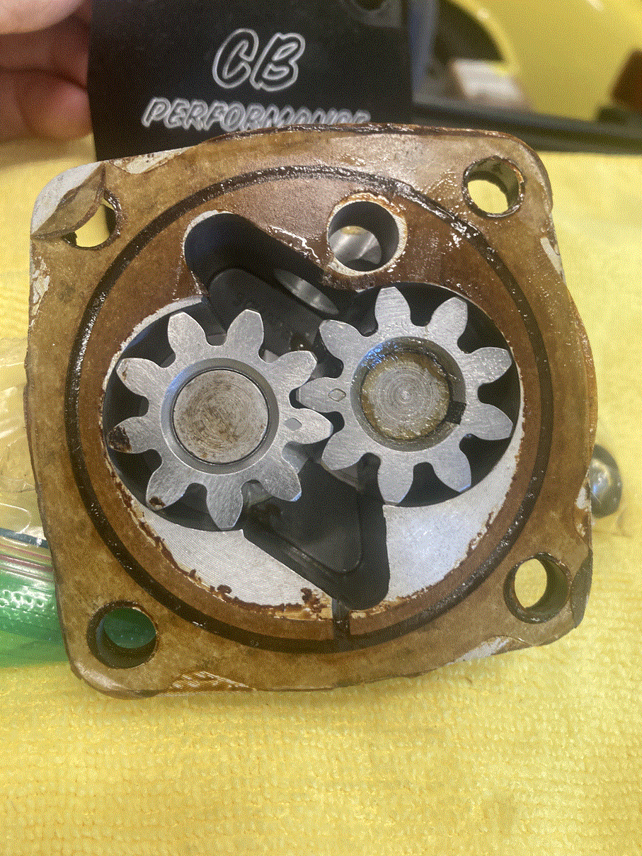

Anyone have an idea what the hole (the one drilled into the oil passage) in the oil pump is for in the upper right of this photo? It's not standard.
@Robroe
Could you post some photos if what's been modified on that oil pump's output passage? Thx!
