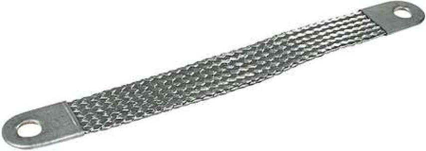

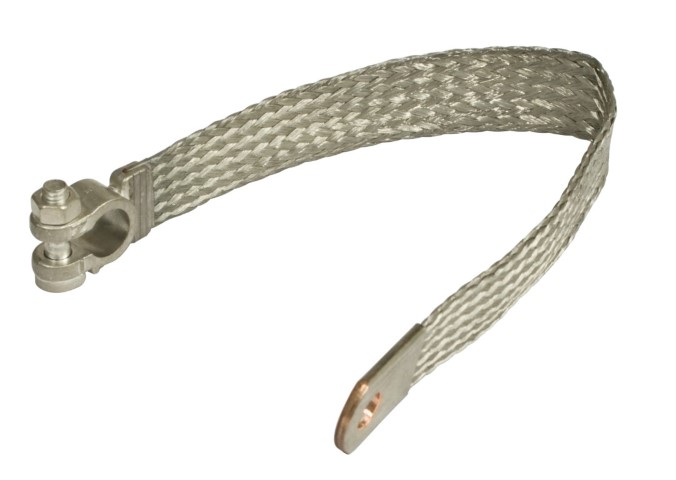

I would start with replacing your negative battery cable with this:
And replace your transmission to body ground strap with this:
These work much better as ground wires than a normal battery cable.
When you replace them, make sure the studs that attach them to the chassis and the transmission are clean and shiny. Use a dremel with a sanding wheel to clean it up. Put a new M8x1.25 nut and star washer on them as well.
Then see how much voltage drop you have.
