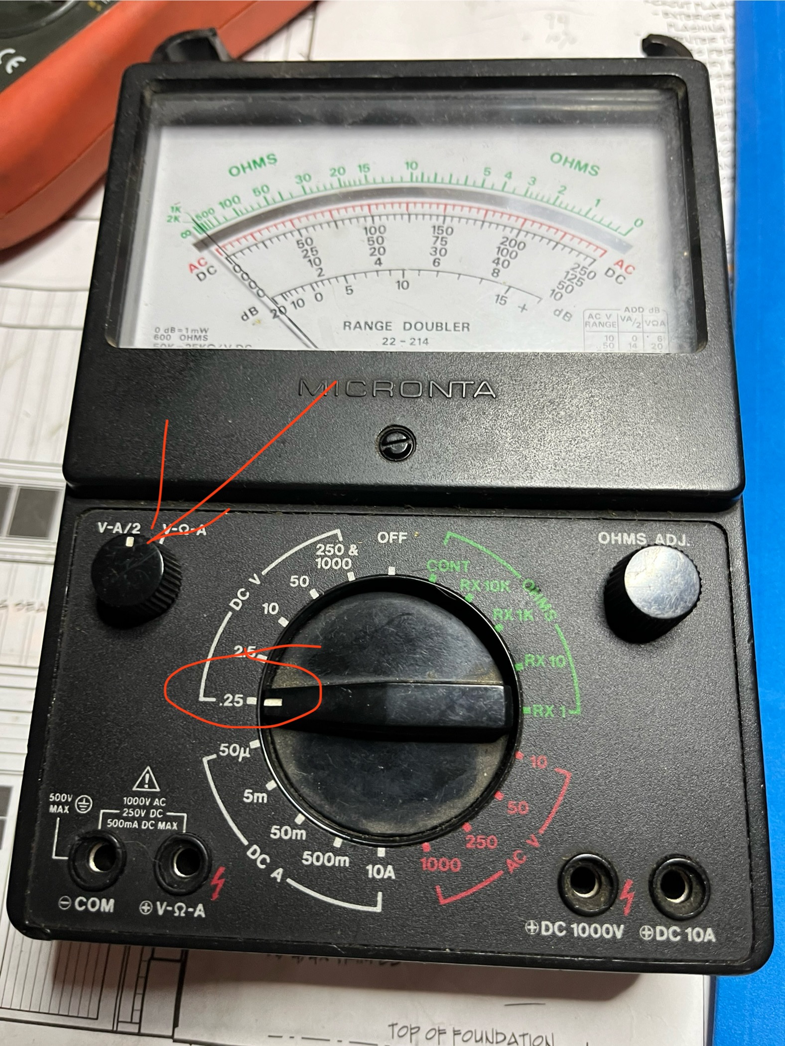

QUOTE(Geezer914 @ Aug 3 2024, 02:28 PM) *
I do not have that scale on my meter.
Use lowest scale you have - something like 2 Volts or less?
Do you know if your meter has auto-range or is it strictly manual scales? Feel free to post pic and we can figure it out.
Here’s another example: old school analog multimeter.
Lowest scale is 250 milli-volts (or 1/4 volt) would work fine for this testing. This meter has an interesting feature that allows that scale to be reduced by 1/2 via a range doubler knob (arrow).
