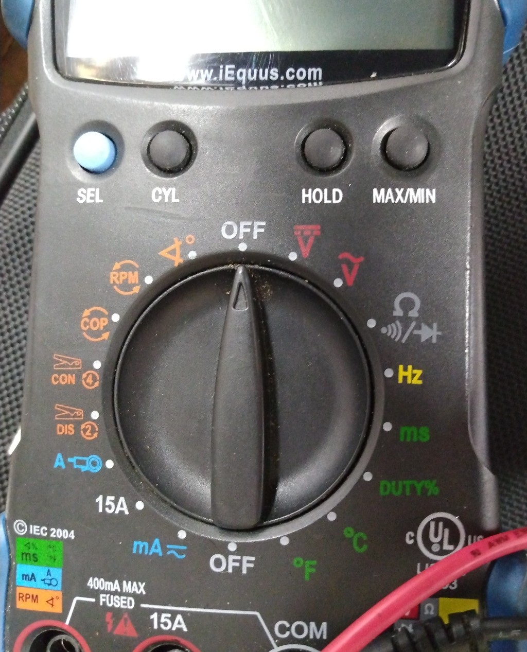

Geezer914   What am I measuring this against?   Aug 3 2024, 08:54 AM
Superhawk996   You are measuring the voltage drop across the nega...   Aug 3 2024, 11:09 AM
Geezer914   I do not have that scale on my meter.   Aug 3 2024, 12:28 PM
Superhawk996   I do not have that scale on my meter. Use lowest...   Aug 3 2024, 12:51 PM
Geezer914   RE: Starting issue   Aug 3 2024, 01:24 PM
Superhawk996   Pulled the manual for your DMM. It is auto-range ...   Aug 3 2024, 01:54 PM
Superhawk996   You could also engage the Min/Max feature to be ab...   Aug 3 2024, 02:07 PM
technicalninja   :agree: :agree: :agree: I use the min/max feat...   Aug 3 2024, 02:49 PM
Geezer914   Just did the test. Meter jumped from 12.14 to 12....   Aug 4 2024, 09:08 AM
