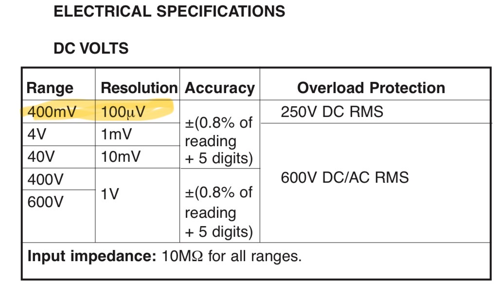

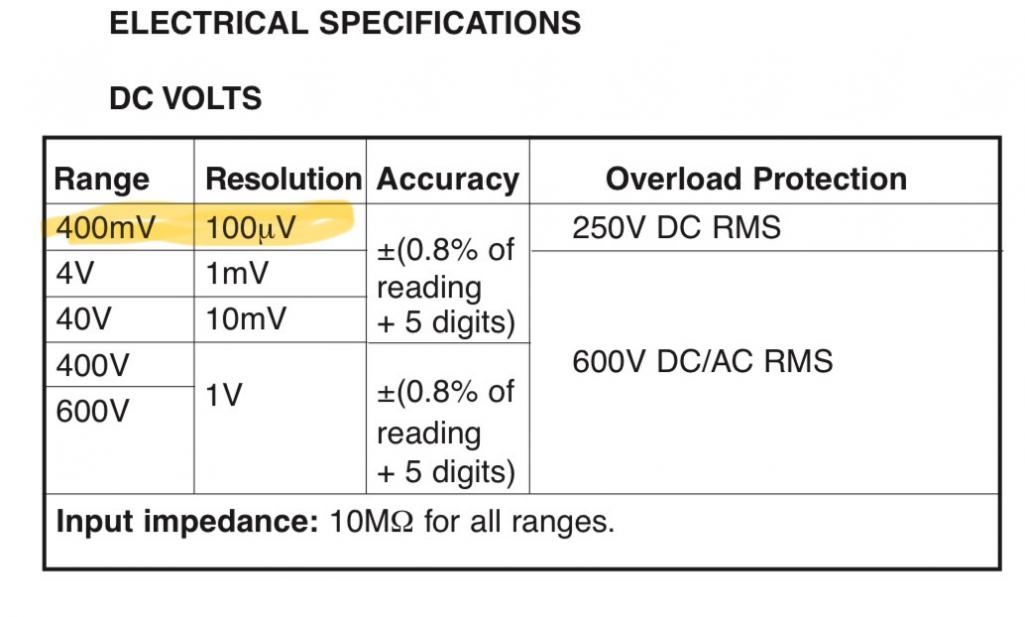

Pulled the manual for your DMM. It is auto-range and it doesn’t appear to allow the range to be set manually.
However, it should be fine as it does appear that part of its “range” is a 400 mV range. Seems a shame it won’t let you select that range manually but life goes on.
Here’s its specs;
When you make your measurements, just allow it a couple seconds to auto range itself down to the appropriate level.
Hopefully, what you’ll be reading is 0.0xx volts. So give it time while the engine is cranking to shift that decimal place over for you.
