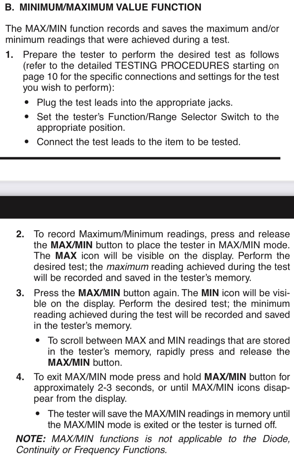

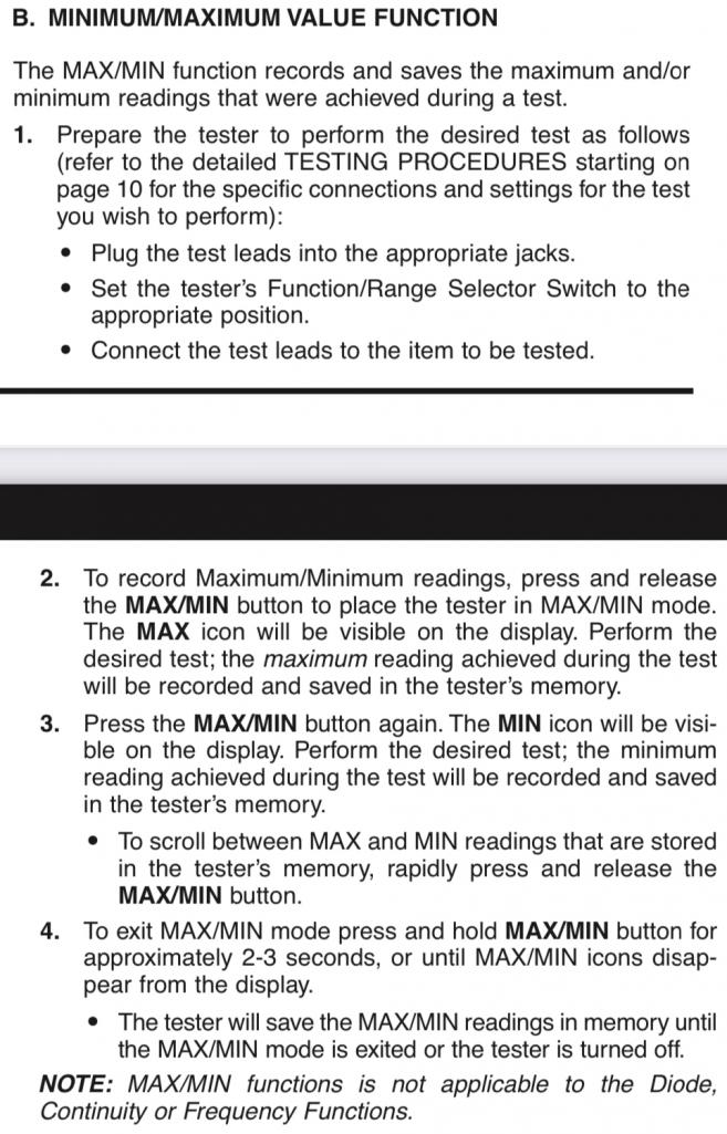

You could also engage the Min/Max feature to be able to do the testing without an assistant.
This feature will automatically capture the highest & lowest readings while it is connected. If you have alligator clips for the leads you can set it up, go crank the starter, then go read the voltages that were stored in the meter.
