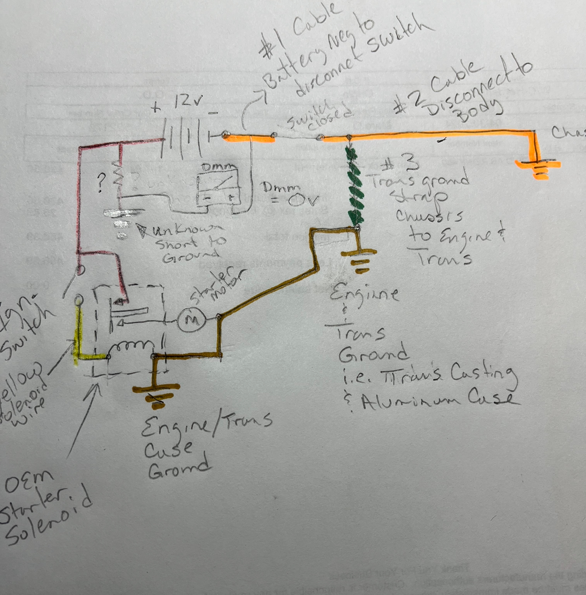

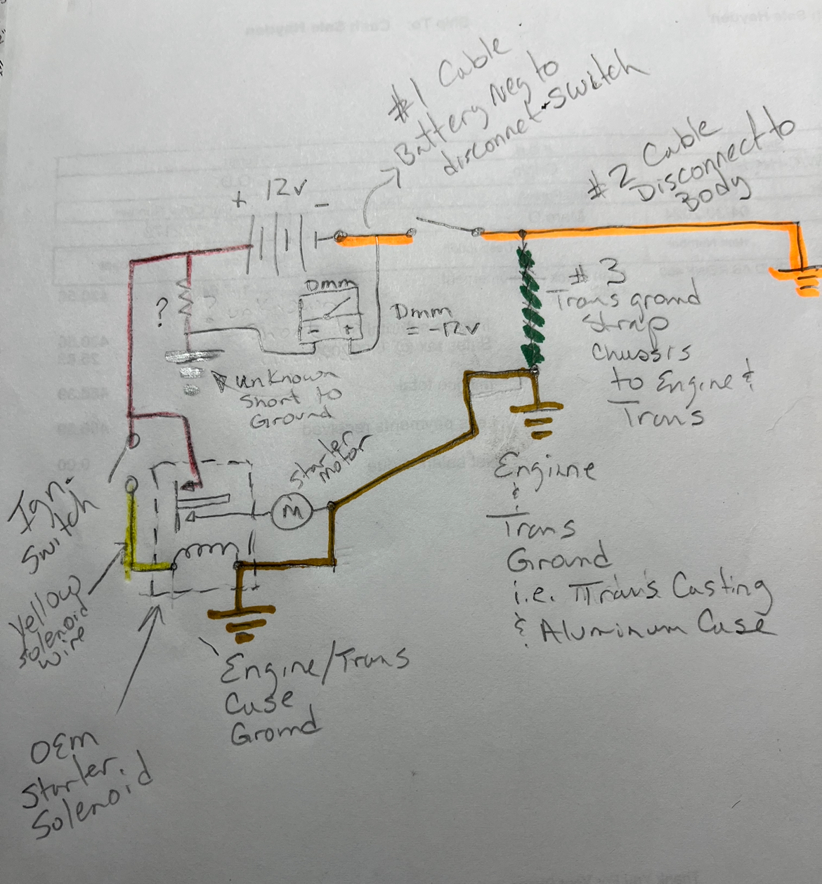

Ok so here’s what I think happened when you measured.
In my drawing recognize that the silver ground symbol and the orange ground symbol represent the same electrical point - chassis ground to body sheetmetal.
I’ve re-drawn with a DMM measuring voltage - black test lead to chassis ground, red test lead to the battery negative side of the disconnect switch.
There are two drawings - one with disconnect switch open the other with it closed
With the disconnect switch open you will measure -12v (negative). If the DMM cables were reversed (red to chassis ground) and black to the disconnect switch, the DMM will read +12v.
With the disconnect switch closed, the DMM will read 0v.
So if you were measuring using Min/Max as I suggested, you would get a -12v reading as Min and 0v as Max instead of 0v Min and a few millivolts as Max as we would be expecting.
This behavior is due to the partial short you have somewhere. the bigger the short the closer to battery voltage you will read on the DMM when the switch is open and the further from 0v will be read when the disconnect switch is closed.
This is why troubleshooting is so important. You have an underlying issue that is causing what seems like crazy readings but it’s what would be expected given the partial short you have.
You can still test the negative ground cables and disconnect switch but I would do it without using the min/max function now that I know you have this underlying problem.
Likewise, it very well may be this underlying partial short problem that is resulting it in you only having 10.86 volts at the yellow solenoid. At a minimum it’s contributing to the voltage drop. The bigger that short, the more it will drag down voltages throughout the vehicle.

Superhawk996   Ok so here’s what I think happened when you meas...   Aug 5 2024, 08:52 AM
