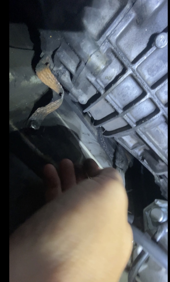

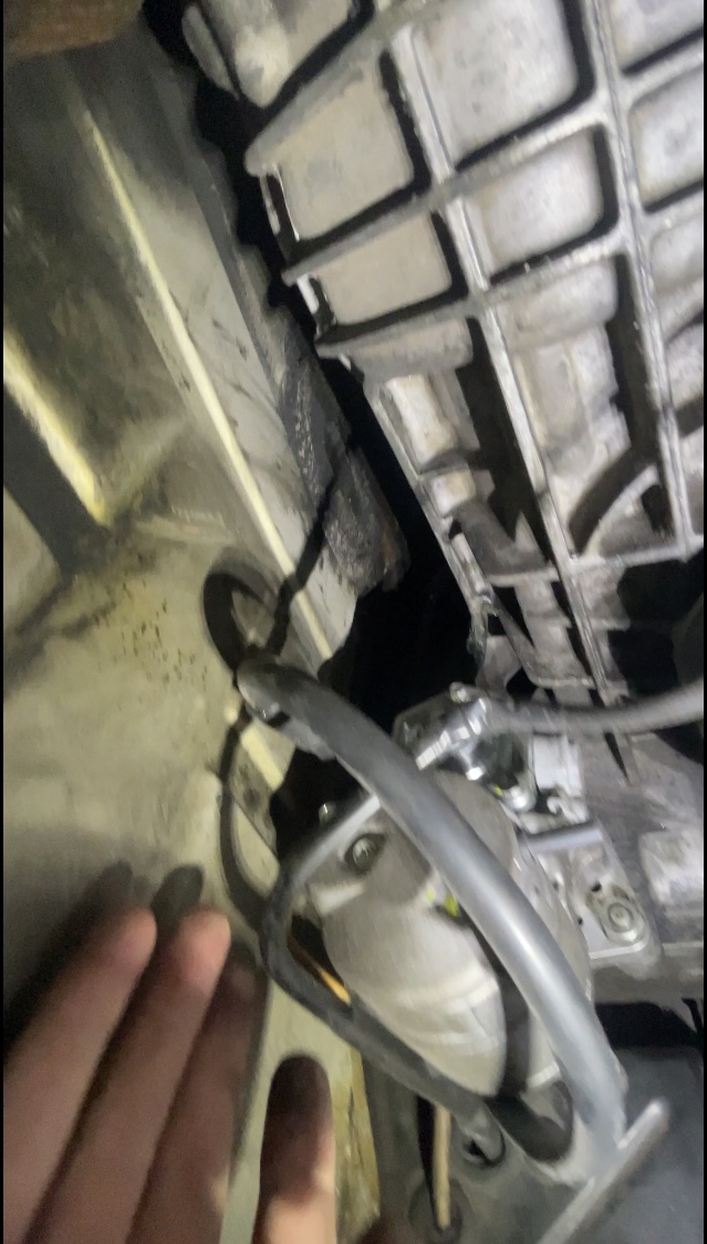

Hey guys,
Just wanted to give you a quick follow-up and say thanks for your help! I crawled under the car and checked the ground metal strap from the tranny to the chassis. It’s there, a bit dirty and probably 50 years old, but still hanging tight. While I was down there, I checked the cables by the starter—everything seemed to be in place. The yellow one isn’t loose, and the big black one (sorry, not sure of the correct name, but you know the one I mean) is also secure. I’ve attached some photos (they’re a bit blurry because they’re screen grabs from a video I took). I couldn’t check the voltage on the yellow wire because I don’t have crocodile clamps yet. But I decided to try starting the car again because, well, why not? I know this is a pretty unorthodox way of troubleshooting—and probably not even troubleshooting at all. As a millennial who’s used to restart buttons on computers (IMG:style_emoticons/default/type.gif) and dreams of being a boomer who understands cars (IMG:style_emoticons/default/welder.gif) , I gave it another shot. By wiggling the key around the ignition switch, it actually started! (IMG:style_emoticons/default/piratenanner.gif) Check out the video here: https://youtube.com/shorts/LTMnpiIOcVo?si=38QUzyNEQHBrYeLl Could this be some kind of secret (now not-so-secret) anti-theft system? Maybe it’s one of those cases where people say cars have souls (IMG:style_emoticons/default/unsure.gif) ? Anyway, it seems like the switch might be on its way out and needs replacing. For now, though, it seems like this was the issue. What do you think? (IMG:style_emoticons/default/pray.gif) |
