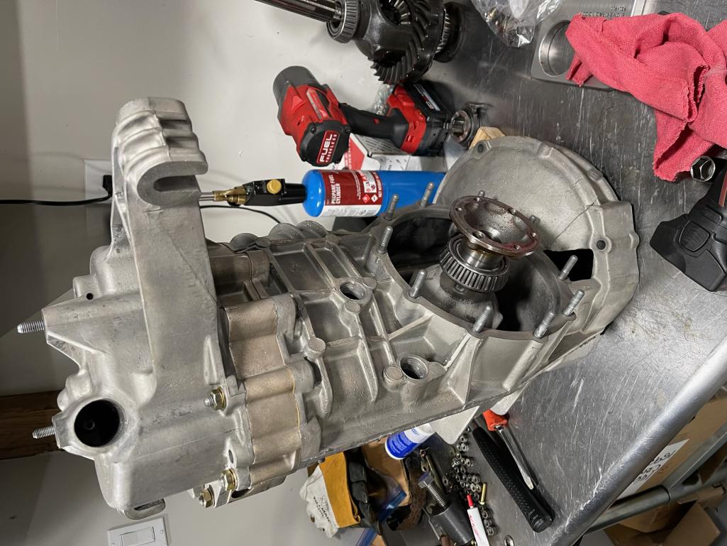

914 trans for a member on this site. Everything was very worn inside so it got a full rebuild with a lot of new parts. Not cheap but should work like new and be good for another 80-100k.
My engine/trans tech was taught by Peter Dawe - one of the very best!

mepstein   Currently on the bench. Early 911 mechanical 915 g...   Aug 11 2024, 05:53 AM
technicalninja   Thanks for the pics @Mepstein I stand corrected...   Aug 11 2024, 09:19 AM
mepstein   All good. We keep a low profile but try to put out...   Aug 11 2024, 10:04 AM
