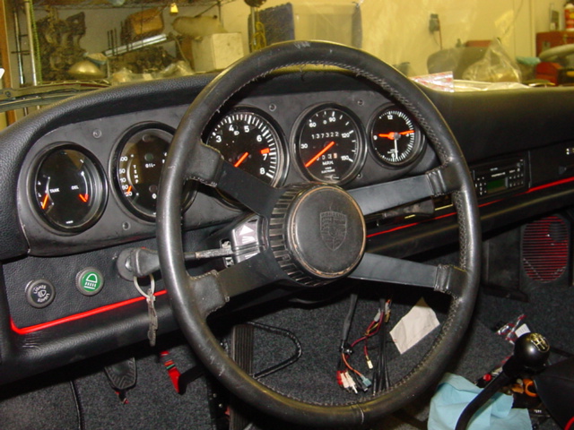

ClayPerrine   Just an update on this project. I got it all hook...   Mar 4 2014, 05:26 PM

ClayPerrine   This is before I sent the speedo out to have it re...   Aug 15 2024, 03:04 PM
ClayPerrine   And this is the speedo today. I just took it 5 min...   Aug 15 2024, 03:13 PM
