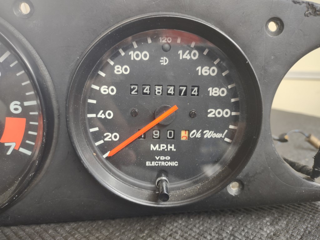

And this is the speedo today. I just took it 5 minutes ago.
It's a custom dash face done by North Hollywood speedometer.
The GPS unit is mounted behind the clock. I can take the clock out of the dash and get to the calibration button on the GPS receiver. That's why the clock has been removed.
