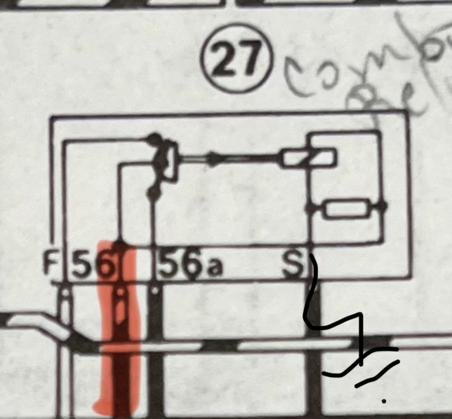

Adding wiring schematic to this thread. Attached Image
