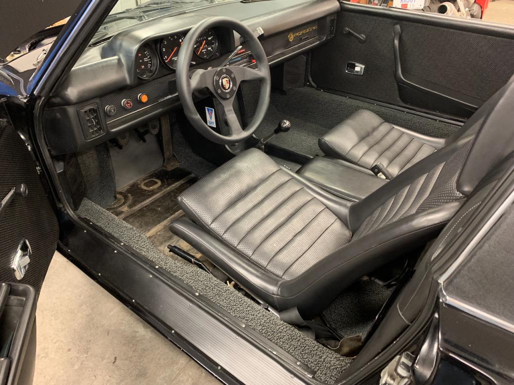

Interior is very clean and fairly original other than the steering wheel and the glove box badge. There is a battery cutoff tucked up on the side of the center console. The driver's carpet isn't installed, it has no grommets and climbs up under the petals; I'm working on that. I haven't yet opened the door panels to see if the frame was cut for speakers.

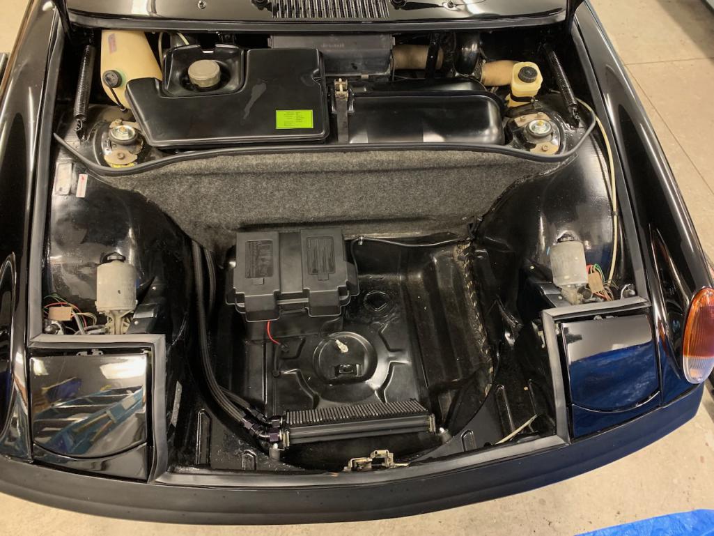

Front Trunk has the battery box and oil cooler. The cooler is plumbed through the heater tube with braided line; I'm sure there are opinions about that. The round in the front panel have been removed, but there isn't any other ventilation. It should heat the battery, but I haven't done any measurements. Anyone have any experience with this kind of setup?

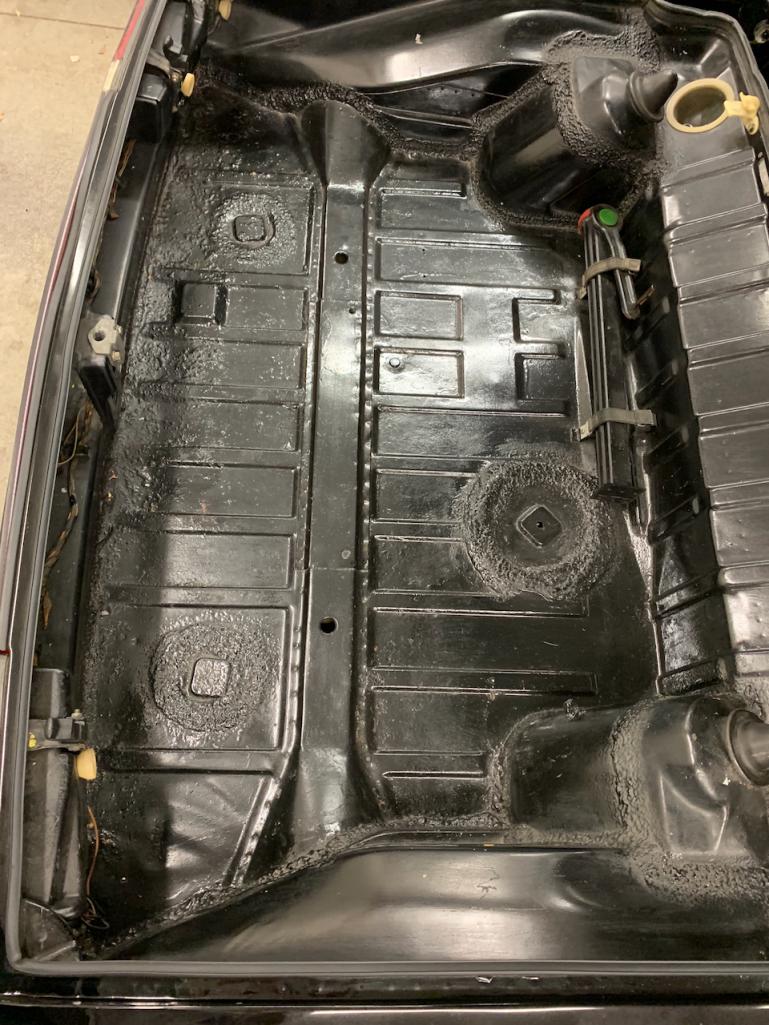

The trunk shows signs of something applied to the rear corners under the shiny paint. I haven't looked too hard yet. Looking up from the bottom may reveal something.
Nice looking 914. Looks like it really scoots.

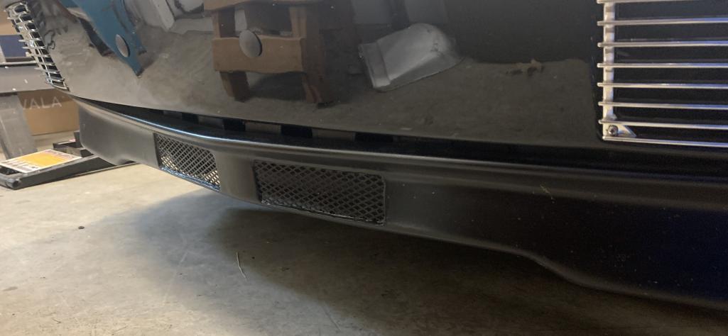

About the oil cooler, you mention the round cut outs in the front panel are open to let air in. Is there a cutout in the front bumper to clear the holes for air?
Once air comes in through the holes, were does it escape? I didn't see any exhaust holes for the heated air.

There is no apparent escape for airflow, other than what filters into the interior and around the trunk gaskets. The engine has its original oil cooler so this cooler may not see much load in normal driving. I haven’t driven the longer than 40 minutes at a time so it may simply not have saturated the enclosed spaces in that short time. I’m thinking to set up a wireless barbecue temperature probe and see what actually is happening.
Here’s a shot of the openings behind the bumper:

You can always remove the round access panel from the bottom of the front trunk. They are held in with seam sealer. I removed them on my 6 conversion to give the air an exit point.
