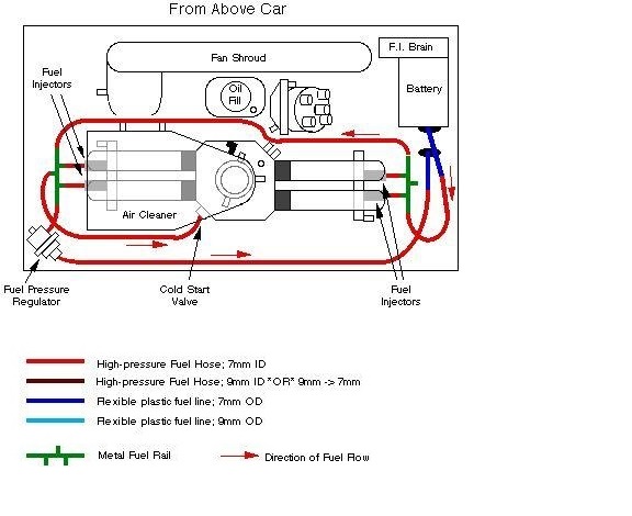

So much to work with here... carbs, return lines for carbs, lots of fun.
Anyway I need to work on some upper fuel lines and was going to add a return line. For folks that have done it, what route did you use for the return? How did you make the hose bend for the 2nd carb if you routed it on the rear wall?
Also, where to add a pressure gauge? Between the pump and the 1st carb, or between the two carbs? What's best for accuracy or does it matter?

NARP74   Return line for carbs   Aug 20 2024, 12:09 PM
914werke   why not use the OE route that was used for FI ?   Aug 20 2024, 12:18 PM
dr914@autoatlanta.com   three nipple 3-6 lb pump factory lines through the...   Aug 20 2024, 12:31 PM
NARP74   "why not use the OE route that was used for F...   Aug 20 2024, 12:34 PM
rgolia   I don't think you really need one.   Aug 20 2024, 12:56 PM
914werke   RE: Return line for carbs   Aug 20 2024, 12:56 PM
914werke   I don't think you really need one. Doesn...   Aug 20 2024, 01:02 PM
VaccaRabite   I don't think you really need one. Doesn...   Aug 20 2024, 01:32 PM
930cabman   I have ran carbed sporting cars for over 50 years,...   Aug 20 2024, 02:07 PM
NARP74   That's why I want to add a gauge. I have no i...   Aug 20 2024, 02:12 PM
rgolia   That's why I want to add a gauge. I have no ...   Aug 20 2024, 03:17 PM
NARP74   I have all the parts for the SS upgrade, pump, fil...   Aug 20 2024, 04:38 PM
barefoot   I mounted fuel pressure regulator just beyond big ...   Aug 22 2024, 06:50 AM
mlindner   Same as 930cabman, running 40 PMO's on my 2.2 ...   Aug 22 2024, 08:54 AM
Literati914   why not use the OE route that was used for FI ? ...   Aug 22 2024, 09:33 AM
Garland   Here’s a great tutorial by a well-known 914 enth...   Aug 22 2024, 11:26 AM
rfinegan   Here is my Carbed return line using the original E...   Aug 22 2024, 11:55 AM
Root_Werks   This is approaching the battery, tire and oil thre...   Aug 22 2024, 12:27 PM
NARP74   I thought mine was a little different. I have rea...   Aug 22 2024, 12:36 PM
Root_Werks   @NARP74 My post seemed sort of snarky, sorry abo...   Aug 22 2024, 04:45 PM
