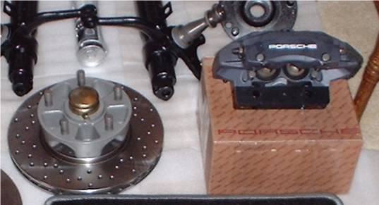

Here is the only pic I have, actually a crop job, of what Rich's kit looks like. It also uses the 3.5" 911 Struts and Carrera rotors. The caliper bracket itself could be made any number of ways as far as I can tell.
