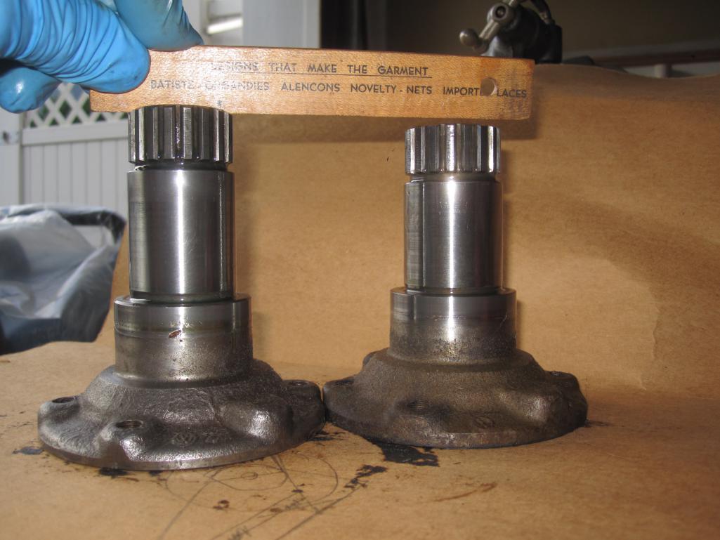

Lot thicker and longer shaft.

LSD output flange

Bingo. Also a lot of confusion over multiple flanges with the same casting number, that are then machined to different tolerances and measurements, and people think that the casting number is the part number. So many variations that are subtle. I have had people send me transmissions with the narrow shaft flange in a standard bore. Wiggle wiggle.
