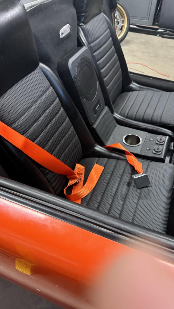

I choose the less hidden route…and I realize it’s very ‘out in the open’ but I do like it. Was making a center section anyway so I feel like it integrated well for what I wanted. not trying to hijack the thread. I love the center console and screen setup you have
