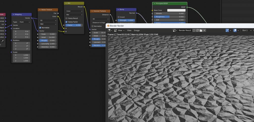

emerygt350   The rabbit hole is deep... I am now learning how ...   Sep 5 2024, 06:05 PM
emerygt350   My brain is melting, but I am almost there...   Sep 6 2024, 10:14 AM
worn   My brain is melting, but I am almost there... ...   Sep 6 2024, 11:42 AM
emerygt350   This stuff is black magic. Makes me have a ton mo...   Sep 6 2024, 03:55 PM
Ishley   I contacted a friend of mine who does printing… ...   Sep 6 2024, 05:39 PM
emerygt350   That is really nice. I should update the files wi...   Sep 6 2024, 06:02 PM
emerygt350   Here is my attempt at leather texture... Now to se...   Sep 7 2024, 09:55 AM
