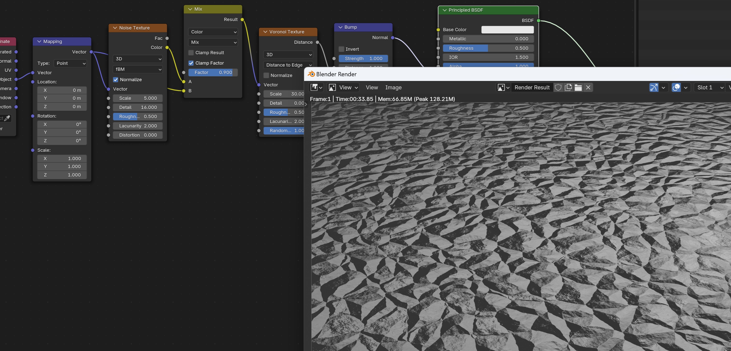

emerygt350   Here is my attempt at leather texture... Now to se...   Sep 7 2024, 09:55 AM
