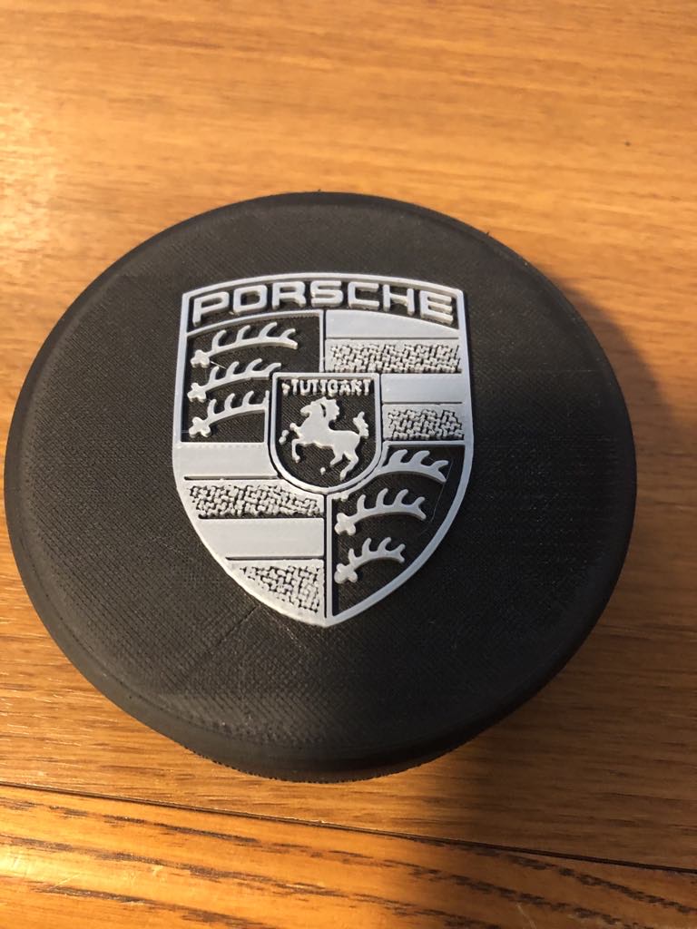

I contacted a friend of mine who does printing… and he ran the first model you published. He said he stopped and changed the wire to silver when it got to the logo portion.
I haven’t physically seen it yet… but I thought you’d be interested in this variation.
