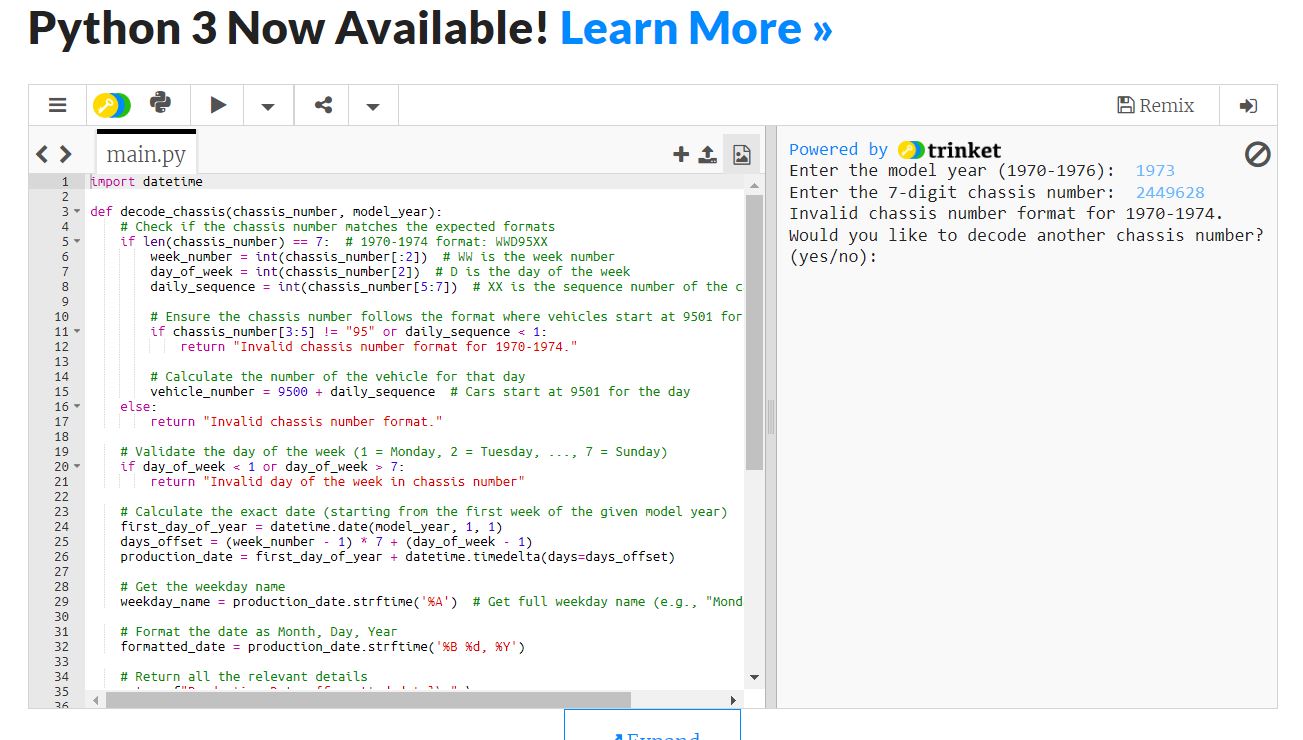

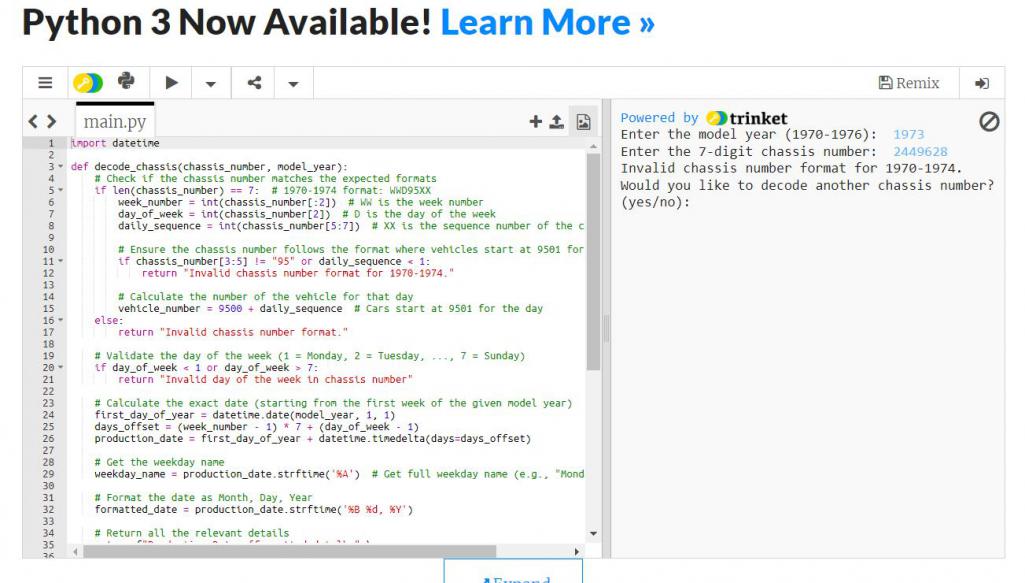

Made a quick and simple chassis number decoder.
Porsche 914 chassis number decoder
If anyone has any issues with it let me know and I can modify it. Appears to work correctly for my 1974 (IMG:style_emoticons/default/smile.gif)

QUOTE(914Wes @ Sep 5 2024, 04:48 PM) *
@914Wes Tried with my 1973 and didn't work. (IMG:style_emoticons/default/sad.gif)

914Wes   Made a quick and simple chassis number decoder. P...   Sep 5 2024, 05:48 PM
Montreal914   Made a quick and simple chassis number decoder. ...   Sep 7 2024, 09:16 AM
SirAndy   [quote name='914Wes' post='3165781' date='Sep 5 2...   Sep 7 2024, 10:37 AM
SirAndy   [quote name='Montreal914' post='3166090' date='Se...   Sep 9 2024, 10:52 AM
914Wes   [quote name='Montreal914' post='3166090' date='S...   Sep 10 2024, 04:14 PM
