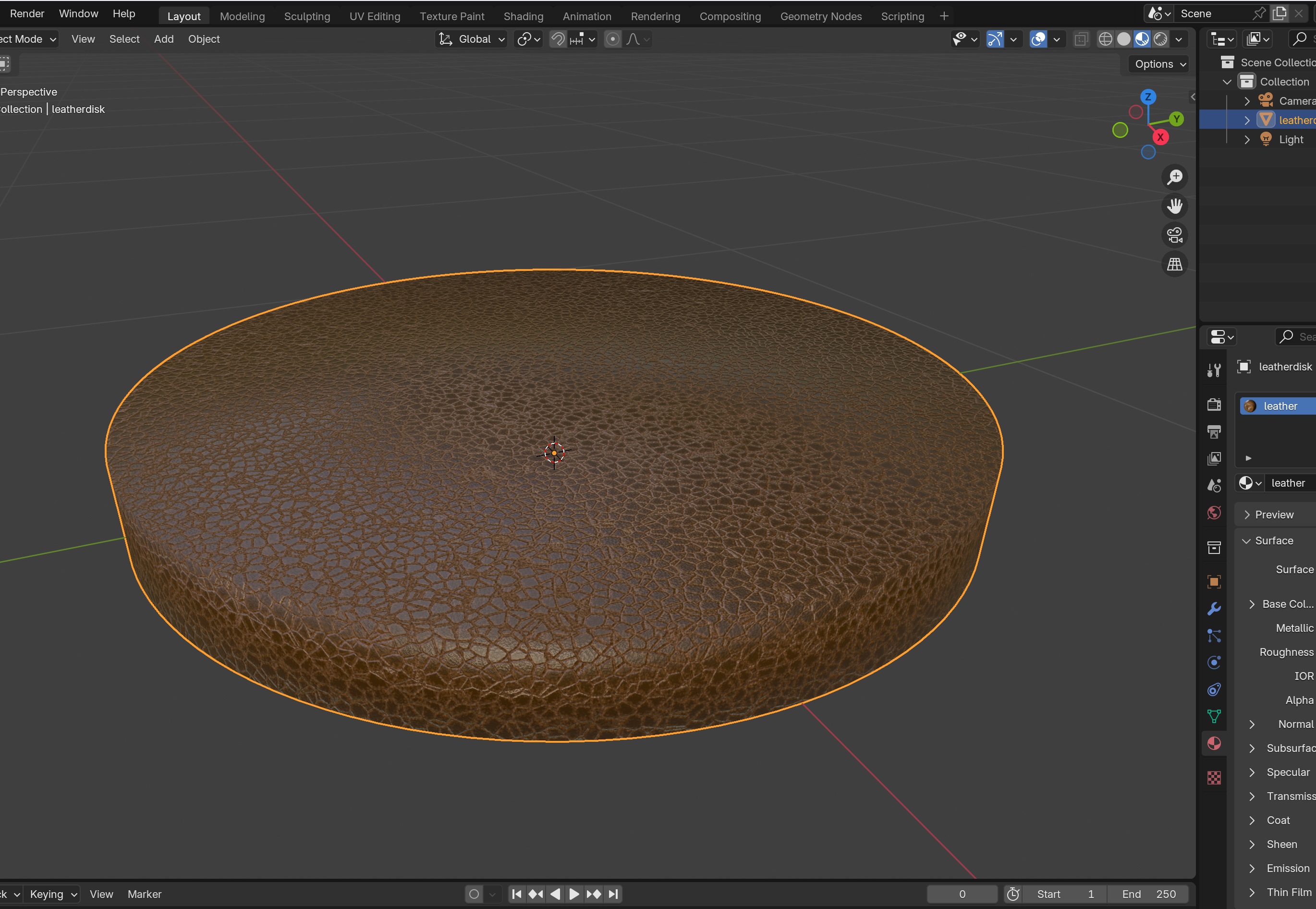

Here is my attempt at leather texture... Now to see how it transfers to a 3dprint...

emerygt350   Here is my attempt at leather texture... Now to se...   Sep 7 2024, 09:55 AM
