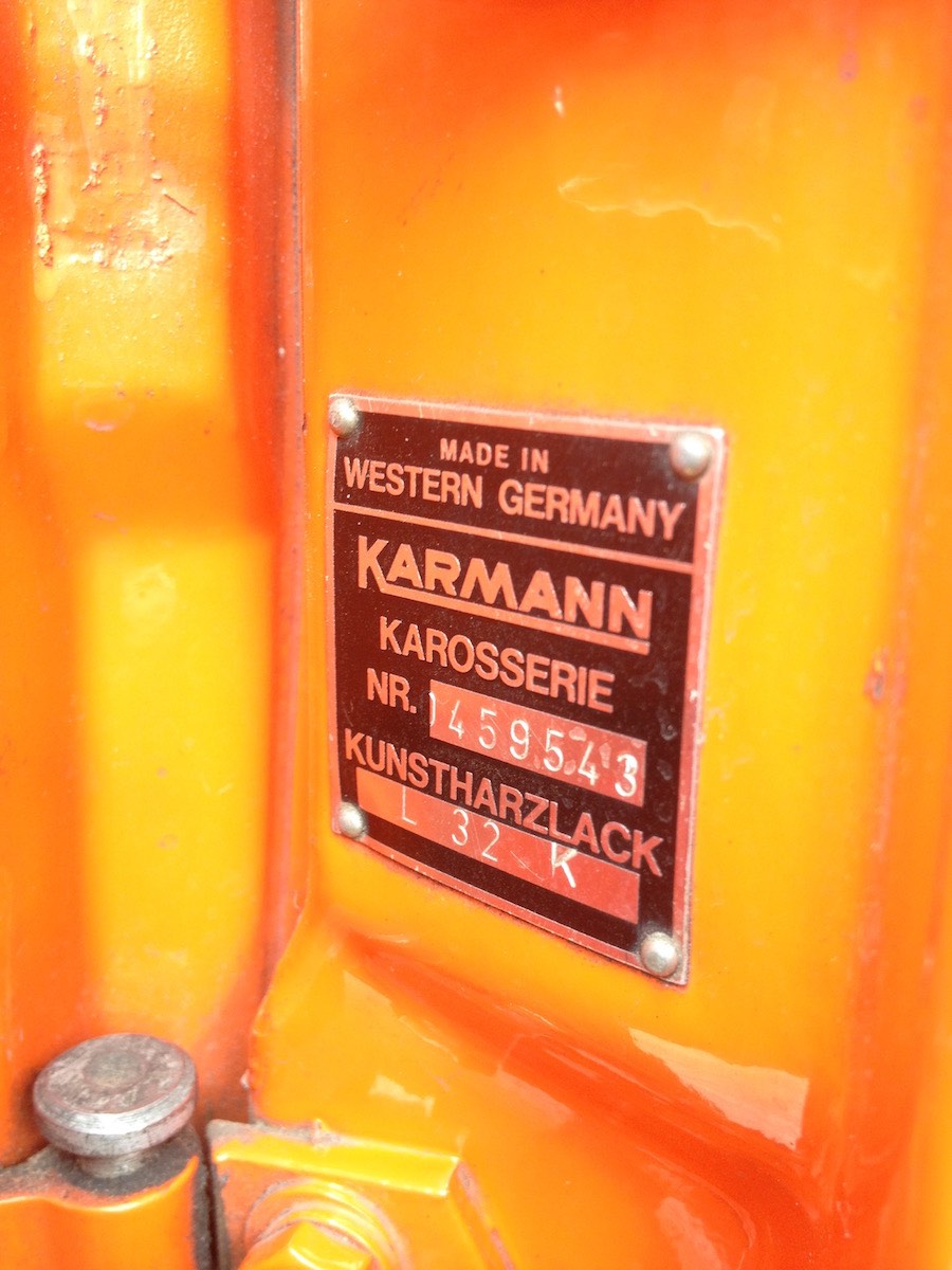

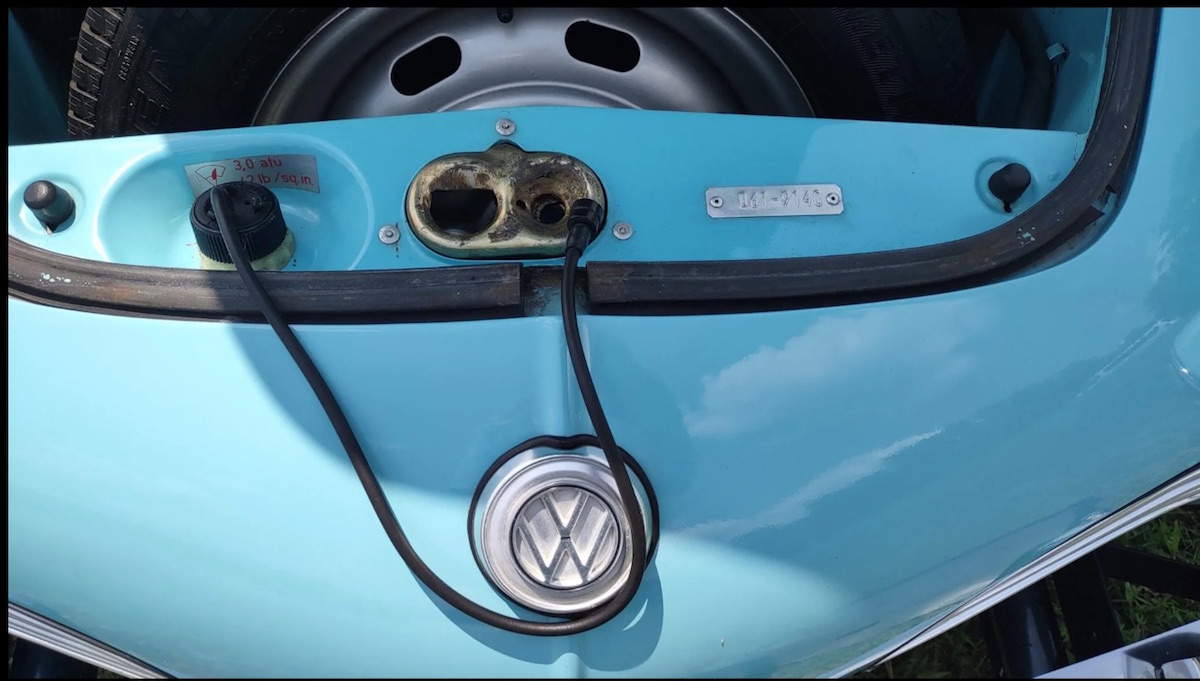

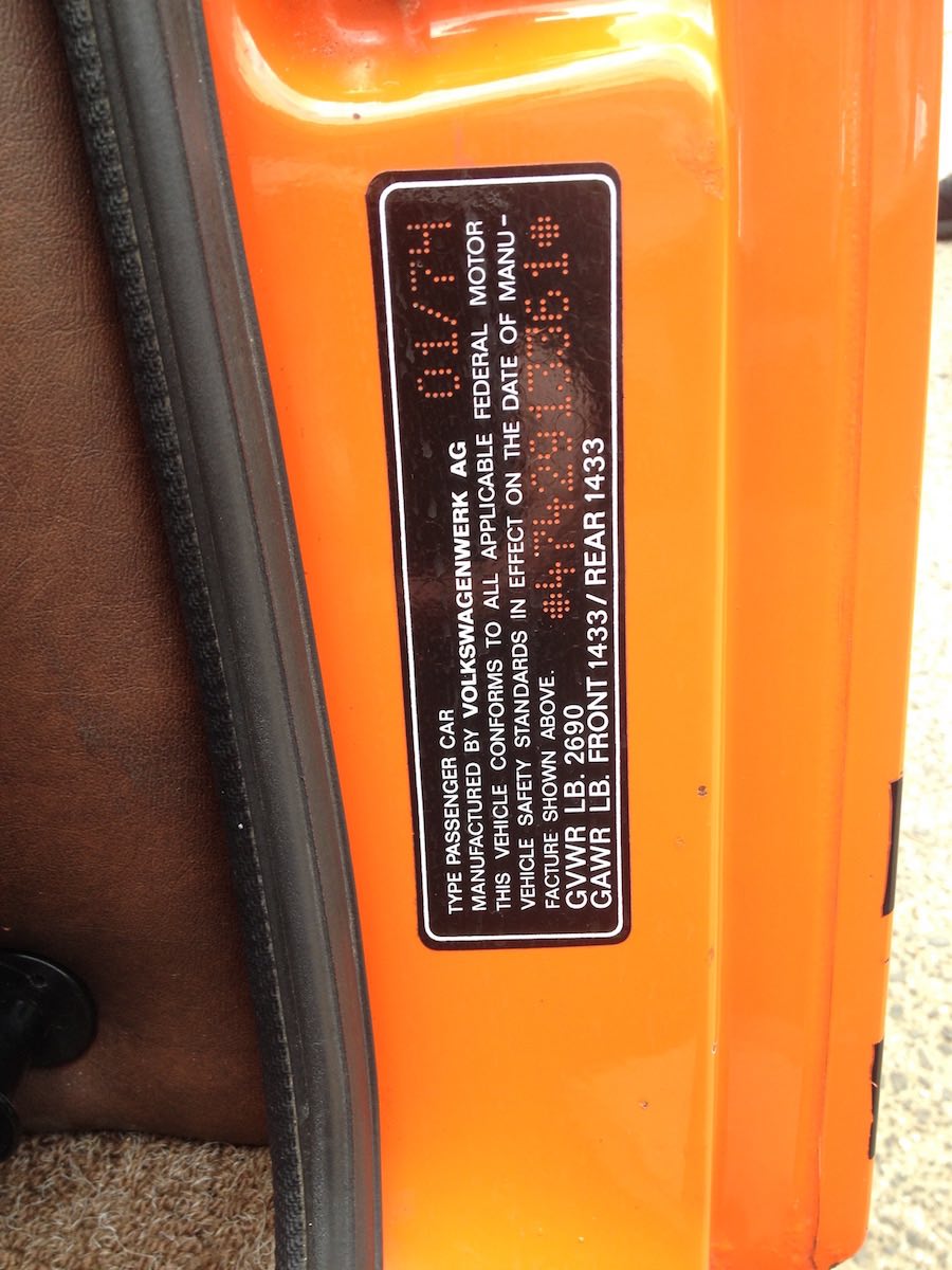

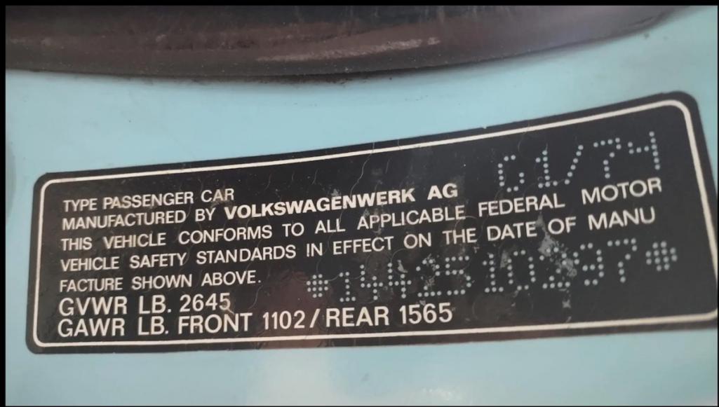

here is something i have on file showing those VW production plate numbers compared to vins for k g and 914.
something i had on file.
direct comparison of kg produced in 74 same time as my 914.
showing my 914 vin and production plate to compare.
i should correct a little what i said above re karmann ghias always using 5.
they are a bit more random than that.
just had a quick look at some on BAT.
its a little harder to tell what is going on.
the one i am showing here has a 5 where 914 has 9.
some later k g have a 7 there.
but i guess what it shows is that the 2 and then the 9 have nothing to do with the karmann factory when it comes to the vin sequence numbers.
1974 karmann ghia. 1/74.
(there is something funny going on with production plate because it is stamped 06 which should make its vin a 2/74. who knows. (IMG:style_emoticons/default/confused24.gif) don't really study k g s on file to the same degree as the L jet stuff i have collected). but anyway this is the point in time they are using a 5 there where the 914 has a 9. and after the 5 is the cumulative production number of the chassis for 74 MY.
i'd have to be doing kg research to get right to the bottom of it.
and its not really something i have time for.
just something i stumbled around the edges of figuring the ins and outs of the 74 1.8s.
.Attached Image
74 914. 1/74.
and all 914s just use the 9. always did.
but it does not mean karmann factory in the case of Vin.
the 9 certainly means karmann factory in the case of the production plate.
its the same on both cars. a 9.
its also there on the VW cabriolets on the production plate.
all cabs came from karmann.
and its probably there on sciroccos as they also had a production plate and came from karmann factory.
