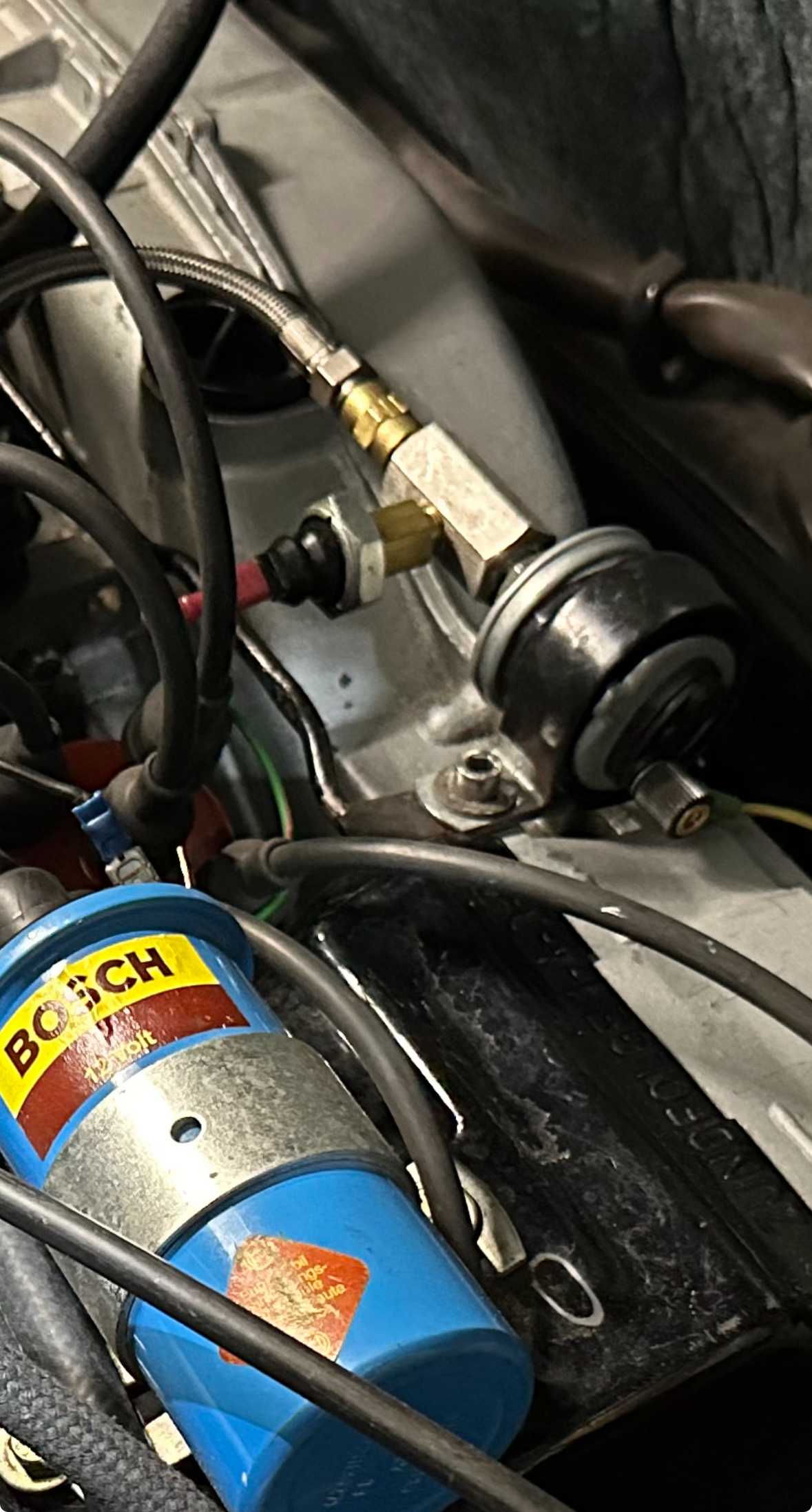

@IanKarr could you share some specs on the oil temp and pressure remote setup in the engine compartment? What bracket, adapter, sensor etc.?

Sure. I'm using a Dakota Diigtal ODYR/SLX-03-1 (pretty sure) gauge with SEN-03 NPT sender. SS braided NPT hose with NPT to M10 adapter installed in the case. On the other end I used a block with a tee so I could use the stock pressure sender on an M10 to NPT adapter for the green light. I mounted the sender with a standard rubber coated conduit clamp available anywhere. I needed a couple wraps of electrical tape around the sender to make it snug. Here are the links...
https://www.amazon.com/gp/product/B0049D63X...=UTF8&psc=1
https://www.amazon.com/gp/product/B07HGH943...=UTF8&psc=1
https://www.amazon.com/gp/product/B07XYVPPZ...=UTF8&psc=1
https://www.amazon.com/gp/product/B07487DR2...e=UTF8&th=1
Pic below.
