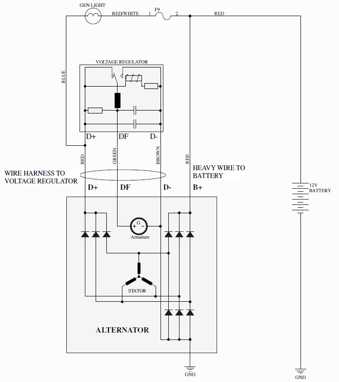

Here's a simplified schematic of the 914 charging system.

Thanks for the fast reply Spoke. These are my measurements I took back probing the Alternator connector at the relay board engine running:
With the Bosch VR that came with the car
Battery Voltage: 12.3V
D+: 13.5V
DF: 6V at idle, 8V at 2500 RPM
D-: 0
Gen light comes on with key on, does not come on with engine running with this VR
Solid State VR
Battery Voltage: 12.87 at idle 13.9 @ 2500
D+: 15-18V(idle to 2500)
DF: 8 to 4.5V (idle to 2500)
D-: 0
Gen light comes on with key on, is dim at idle and gets brighter with RPM with this VR
I also did a voltage drop test from the starter lug to the battery positive terminal and that was good. Car seems to crank easy. Battery is pretty new.
Side note, do you know where the ground strap from the transmission to the body is supposed to be located?
Spoke
post Sep 8 2024, 06:38 PM
Jerry
Posts: 7,438
Joined: 29-October 04
From: Allentown, PA
Member No.: 3,031
QUOTE(kostritzer @ Sep 8 2024, 12:57 PM) *
D+: 13.5V
D-: 0
With Batt being 1.2V lower than D+, it almost seems like a diode is open on the battery side. D+ and VBATT should be very similar.
Solid State VR
D-: 0
The SS VR results makes me wonder if the VR is oscillating and is not stable. The D+ for the Bosch unit was stable at 13.5V (perfect) but you see variation 15-18V on D+ with the SS VR.
With both VRs it looks like the battery voltage is significantly below the D+ voltage. I won't go as far a saying something is wrong with your alternator but it sure looks like it from the data. Hopefully someone else will chime in with their thoughts.
