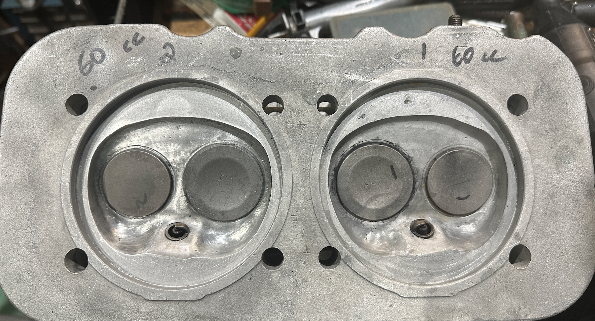

Thanks for the pics of the 2.0 chambers. MY heads were welded and reinforced by the plug but were not consistent chambers to chamber. One measure 58cc and the other was 60. Surprising how much aluminum you have to remove for 2 CC
The other head is almost done and I can retouch the seats followed by the fly cut to get about 57 cc for 9.1 static compression
