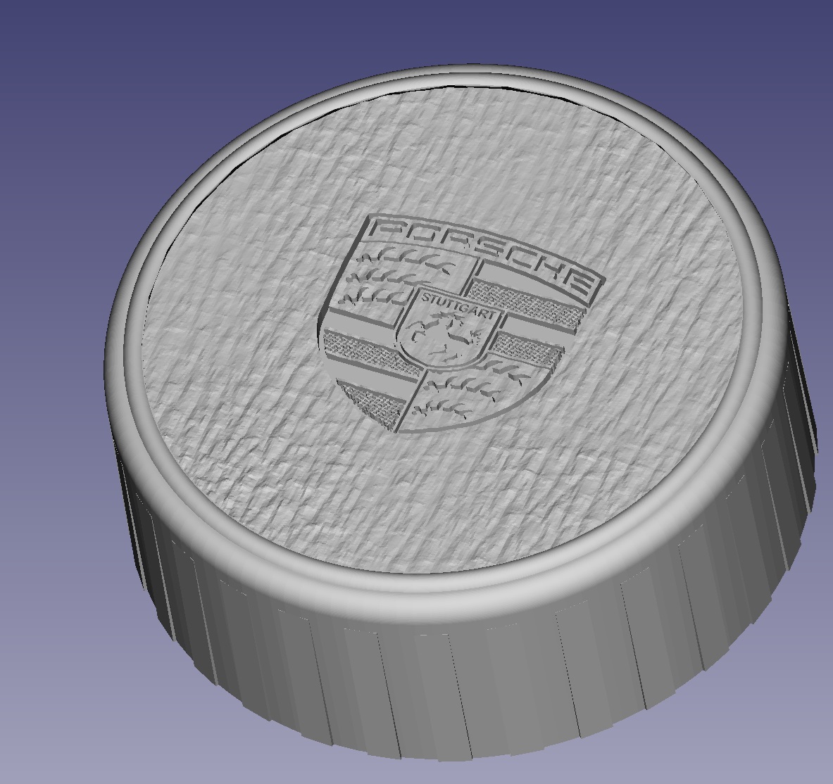

but to get it for nothing on a 3d printer all you need is this!
After I run a test print I will put it up on thingiverse..
Man, that was a learning experience.
Looks like I distorted the Porsche emblem so it needs some more tweaking...

emerygt350   nice. I am learning how to use lattice2 in freeca...   Sep 4 2024, 12:14 PM
emerygt350   it's getting there...   Sep 4 2024, 12:55 PM

emerygt350   Here is my new draft... I will export it to a stl ...   Sep 5 2024, 11:18 AM

emerygt350   The rabbit hole is deep... I am now learning how ...   Sep 5 2024, 06:05 PM
emerygt350   My brain is melting, but I am almost there...   Sep 6 2024, 10:14 AM

emerygt350   This stuff is black magic. Makes me have a ton mo...   Sep 6 2024, 03:55 PM

emerygt350   Here is my attempt at leather texture... Now to se...   Sep 7 2024, 09:55 AM
emerygt350   slowly making progress...   Sep 13 2024, 07:07 AM

emerygt350   I have uploaded the most recent version. I have b...   Sep 23 2024, 10:46 AM
